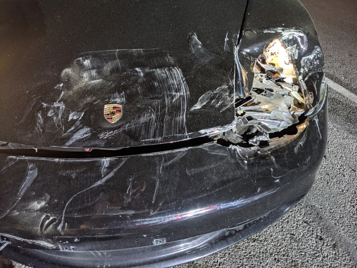

The suv rolled up on top of the hood, so it may have avoided the frame. Radiator may have been spared. I plan on driving it till it dies, so I'm not worried about reselling.

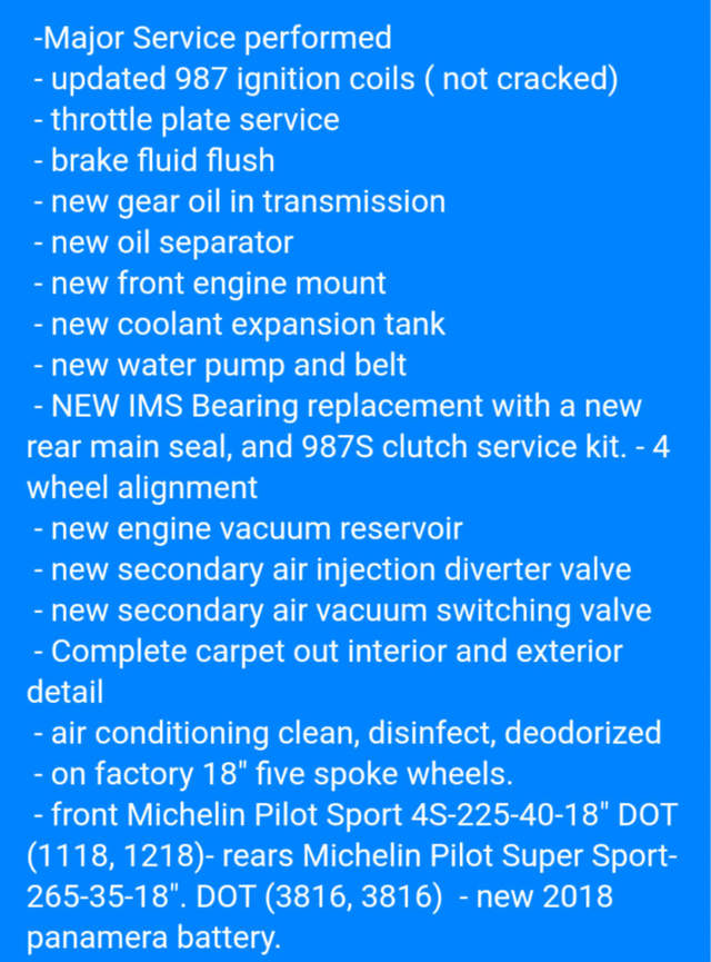

It's an '03 base, 134k miles. I bought a year & a half ago from a Porsche technician who fixed it up for his wife. He made a ton of improvements (see below), so that's why I'm considering keeping it. Seems I wouldn't be able to find one with comparable upkeep for what I bought it for ($7500).

Not quite sure how STL arrived at $1k for parts estimate. Just at first glance and it looks like the following are needed (at minimum):
Front hood
Front Bumper cover and supports
Left fender
Left headlight
Given OEM pricing, that list looks like multiple thousands of $ in parts (not including prep paint fitting and pulling the old parts).
Unless you’re very DIY oriented, I think you’re best off fighting for top dollar cash out on the total. Maybe but it back to part out if you think you can make some extra in doing so (or if there were some especially rare options like aluminum/CF interior trim that you might want to keep for the next one). Then hunt for the next one to own that’s hopefully better than this one even was.

When I look at your pictures, I think I had a similar accident. Fender, hood, radiator, headlight. Not even a scratch on the back bumper of the truck I slid into. Couldn't be much, could it? No sweat right.
On mine I got out of the car thinking $3,500. Car was drive-able. But when I looked really hard the doors had even been pressed into the back of the door frame and the doors. Since it was a '99 it popped the covers off the mounting points for a roof rack those early cars came equipped with that are on the top of the fenders behind the doors. Which showed how far back the damage was. This was confirmed once the shop put the frame on a laser machine (some shops use a frame jig supplied by Porsche) and measured what is out of wack.The quote to repair was $26k when they stopped counting. Now granted that was at the best shop in town but it was also more than 18 years ago.
I think the front of your car (tub) was pressed back far enough that the fenders pushed against the front of the door frame and maybe into the doors. Doesn't one of the pictures show a distortion there?
How fast was the contact? Just a backing up in a parking lot with the weight of an SUV?
If more do you want to drive around in a car where all the safety that saved you has been compromised? Parts don't distort the same way the second time. Buy a roller, buy the crashed car for parts and swap the parts you know you have improved.

In your picture, the driver's side headlight is still working and the frunk looks like it's staying latched. What's the problem? Are they really that picky about cosmetics in California?
I don't see a collision; Crinkled hood and some scuffs.
