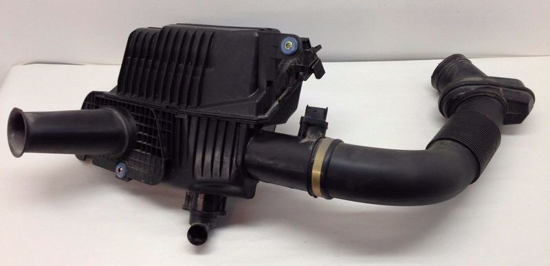

Old 02-17-2020, 01:28 PM   #10
1998 Boxster Silver/Red
Join Date: Sep 2017
Location: 92262
Posts: 3,122
That pipe/hose coming out the bottom of the housing...
What is that for? To what is connected? What is the purpose of it?
Thank you.
1998 Porsche Boxster
Old 02-17-2020, 04:32 PM   #11
Who's askin'?
maytag's Avatar
Join Date: Mar 2018
Location: Utah
Posts: 2,448
Thank you.
Drain
Old 02-17-2020, 10:03 PM   #12
Join Date: Aug 2017
Location: Tucson,az
Posts: 778
Is it possible to loosen the bolts on the air box to then move it around enough to get to the fuel rail,.?? Thanks
flmont is offline   Reply With Quote
