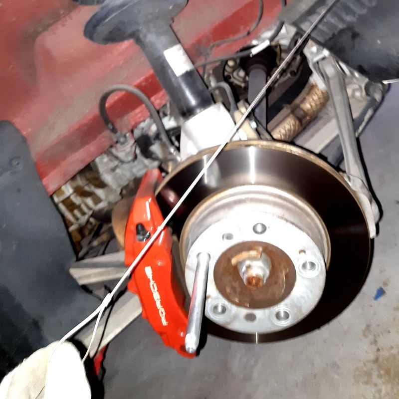

Took off the wheel, found cord, pulled cord. Feels like its attached to a tree. No movement, no noise and its not budging. How screwed am I ?

It may take a good yank to open the lid with the cable. the problem is the routing of the cable: does anyone remember where this wire feeds through?
Once you get it open you will need to replace the latch solenoid with a new one. They get lazy eventually.

Okay, it looks like I lied about the bumper. If you rais and remove the spoiler, you have access to the 3 screws at the top of the bumper

Also note that on my car, the cable is routed through a grommet placed just below the left tail light. this grommet goes towards the rear of the car. So removing the bumper would give you access to the area where the grommet is placed and might make pulling the cable easier.

Getting very close 😐

Somehow a little clip had fallen off. Then one of the cables.
I removed the spoiler, 2 bolts, pulled out the seal and could see the latch. If I would of had a solid flexible rod like a welding rod I would of saved a lot of time by pulling the inside emergency latch. I could see it too.
