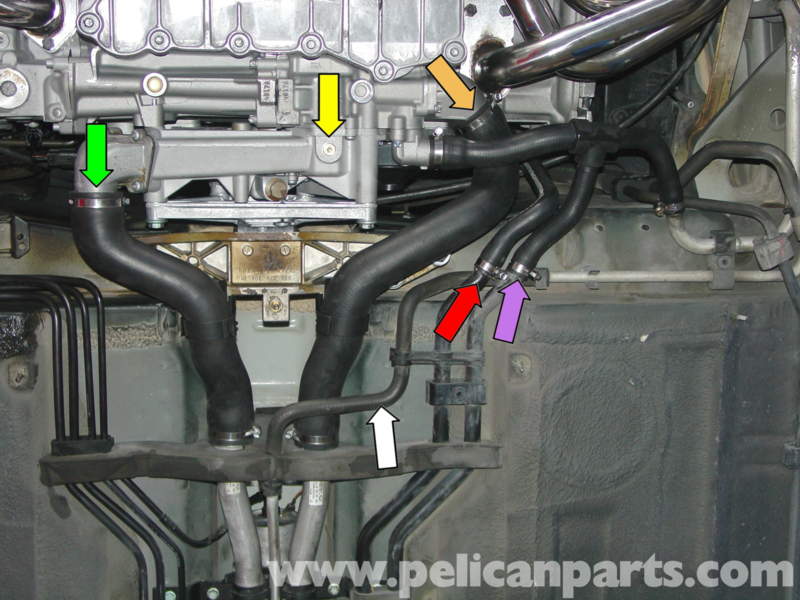

Any advice, strike that, part numbers and diagrams for the rubber hoses in the cooling system. There are about a dozen and I can’t figure out what I want cruising around the bet. I have 2001 and 2002 Boxster 3.2 S, one is a tip and the other manual. Hoses differ a little.
Every other car I’ve had, I could get parts diagrams and could figure it out on my own. Even the dealer parts counter is challenged.
Anyone else figured this out, I promise I’ll share
Old 06-06-2019, 05:09 AM   #20
Will there be cake?
tonythetiger's Avatar
Join Date: Mar 2017
Location: East Coast
Posts: 623
parts list for cooling hoses and clamps near engine
Keeping in mind that the hose from water pump is different for the tiptronics, found this in another post and it has me on my way; Manual 986 Boxster S:
1 900-123-144-30 Crush Washer/Sealing Ring for Coolant Drain Plug (10 X 14 X 1 mm), Boxster/Boxster S (1997-04)
1 996-106-222-17 Water Hose to Water Pump (3-Way Hose), Boxster/Boxster S w/Manual Trans. (1997-04) (Purple Arrow)
OR
1 996-106-522-04 Water hose to water pump (4-way hose), tiptronic (2000-2004) (Purple Arrow)
*(1997-99) use 996-106-222-16
1 996-106-501-07 Water Hose to Water Flange at Oil Pump Housing (Large Hose), Boxster/Boxster S (1997-04) (Orange Arrow)
1 996-106-502-06 Water Hose to Water Flange (Large Hose), 986 Boxster/Boxster S (1997-04) (Green Arrow)
1 999-512-609-09 Hose Clamp 32 x 12
2 999-512-589-09 Hose Clamp 25 z 12
2 999-512-594-09 Hose Clamp 53 x 12
2 999-512-668-09 Hose Clamp 49 x 12
