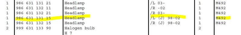

I am looking at buying a pair of Boxter headlights. They have the number 98663103115. I don't know if they are for left-hand drive or right hand driving in Japan as they're being sold out of Japan. Does anybody know about these numbers and if these would point left or right?

I checked the USA/Canada and Rest-of-World Catalogs and didn't find that part number or ANY that had "031 15".
The ROW catalog does have headlights listed as 98663113115.

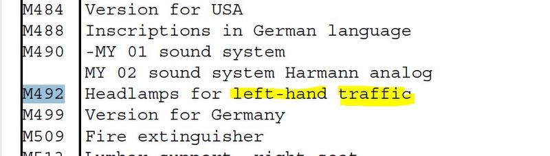

"986 631 131 15" and they are for "left-hand traffic" which is (Japan), right hand drive.
