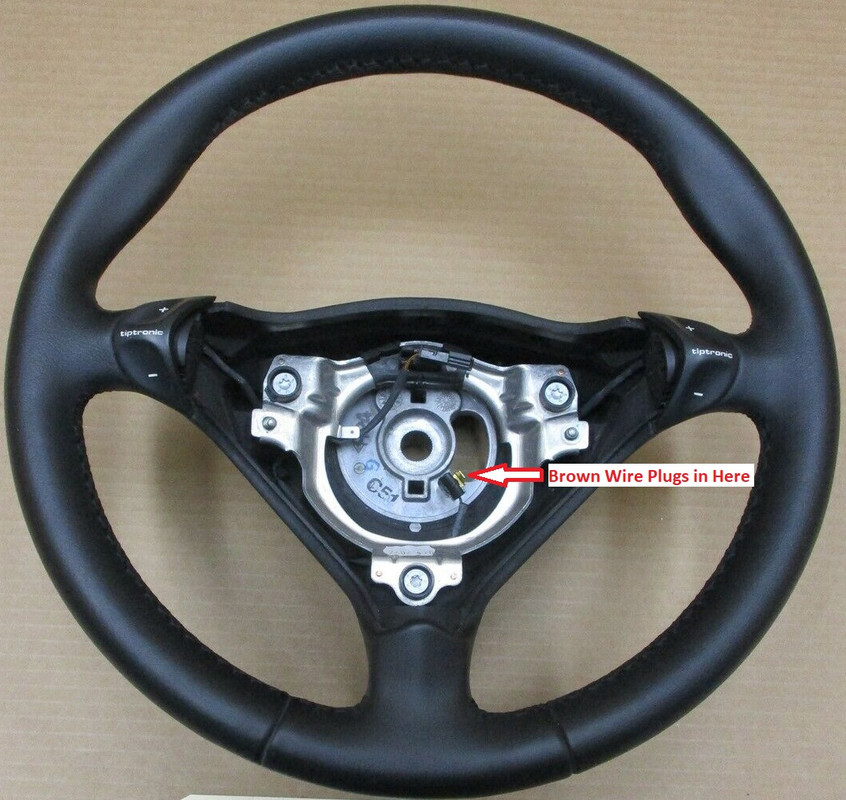

My 2001 Boxster horn only works when the key is removed. I’ve checked the fuses and the grounds...only thing left is the horn relay. Anyone solve this problem?

There is a brown wire under the air bag that has broken loose. You will need to pull the air bag and reattach the wire. Very easy to do.
