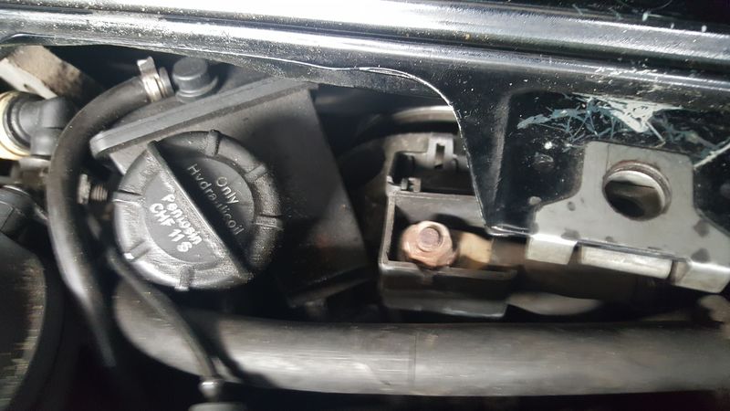

My problem turned out to be a weak "positive" ground in the engine compartment. It was rusty, and if I wiggled the cable and turned the key the engine would start. Disconnect the battery. It is located in a black plastic box next to the power steering reservoir. Use a screw driver to pop the box open and a 14 mm socket to remove and clean the nut.
