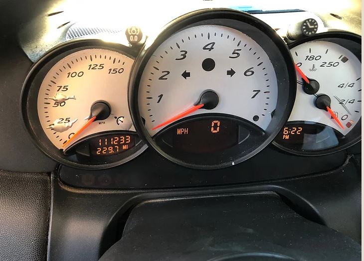

Question Bubble under a gauge face 1999
All,
N00b here and trying to purchase my first Boxster. This 1999 I'm about to pull the trigger on has one tiny, odd flaw....It has a few bubbles on a speedometer face. A) Has anyone ever seen this? B) Carfax is perfect...what might cause it other than Florida heat? and lastly C) ideas on installing a new face?
Thanks everyone! Hope to join you all in ownership soon!

Those are the stick-on gauge faces that someone added.
Fix by removing them (gauge faces will be black underneath) or buying a used cluster to swap faces with if you prefer the silver/white style.
BTW, I see bubbles on all 3.
Thanks for that! I'm not a fan of white anyway. At the risk of sounding helpless, I haven't been able to find a thread on adding or removing gauge faces. The whole cluster...yes. but not opening up the gauge. Are you aware of any how to's in that? Thanks again!

Check youtube under 986 gauge cluster light replacement and you will find quite a bit.

Check out this post on Rennlist: https://rennlist.com/forums/boxster-and-boxster-s-986-forum/915925-programming-a-996-cluster-to-work-in-a-986-a.html
It contains the instructions I posted for reprogramming a 996 cluster. It also has instructions for disassembling the cluster. This article has some information on removing the cluster from the car:
https://www.pelicanparts.com/techarticles/Boxster_Tech/90-ELEC-996_Cluster/90-ELEC-996_Cluster.htm
