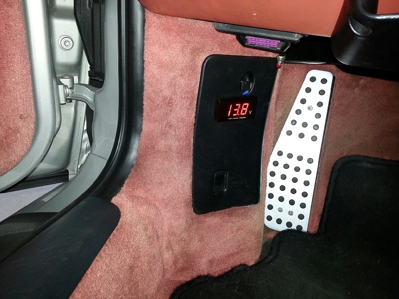

I replaced my battery a couple years ago.
These batteries will lull you into false security.
They work with no warning they are going bad, then out of no where, any time, even after a long drive , "Click Click Click Click...."
This is a common story I have heard from other forum members
Mine was a Walmart parking lot after a 2 hour drive and several years of faithful service.
Now maybe if I had been monitoring the voltage I would have seen it coming
eBay. <$8 Lots of choices.
1998 Porsche Boxster
Old 10-19-2018, 09:14 AM   #31
Join Date: Jan 2014
Posts: 1,631
Attachment 21713
Nice, can you tell us how you wired it?
