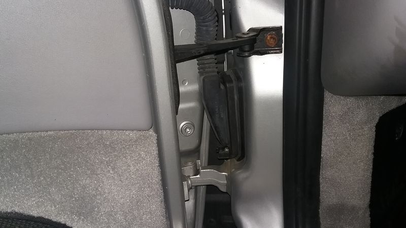

Try checking the harness connection between the door and the car. I was having strange door issues and mine was full of water and corroded. There are +/-15 connections inside that plug. Apparently it is a known issue for wet climates.

Here is the picture I PM you about.
