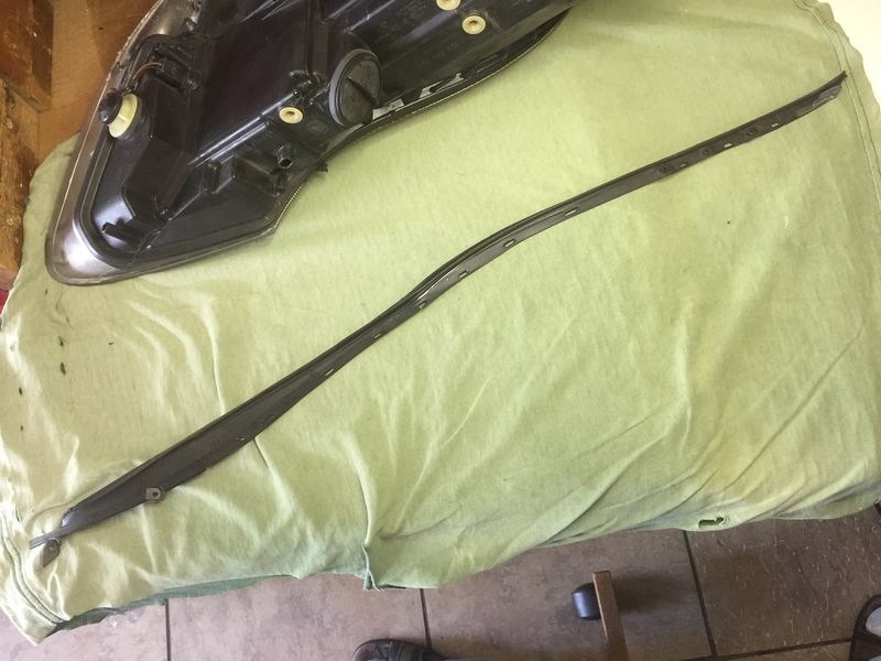

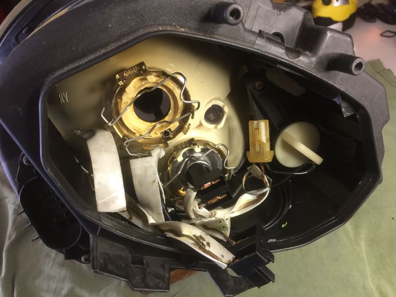

Ahhh...the joys of being the 5th owner of a vehicle. Whoever did the surgery on this Stallion's eyes should be Porsche-Whipped...
The ever-elusive headlight weather strip...

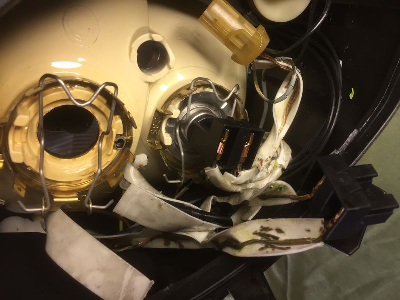

The tape on the wiring is due to the failure of the biodegradable insulation that Porsche and other German manufacturers used starting in the 1990s. You can read it about it here: https://jalopnik.com/5570865/11-terrible-automotive-engineering-decisions/ and here:http://986forum.com/forums/boxster-general-discussions/58768-boxster-headlamp-assembly-internal-wiring.html
The repair is not too difficult, but it does require opening the headlight and replacing the offending wire.

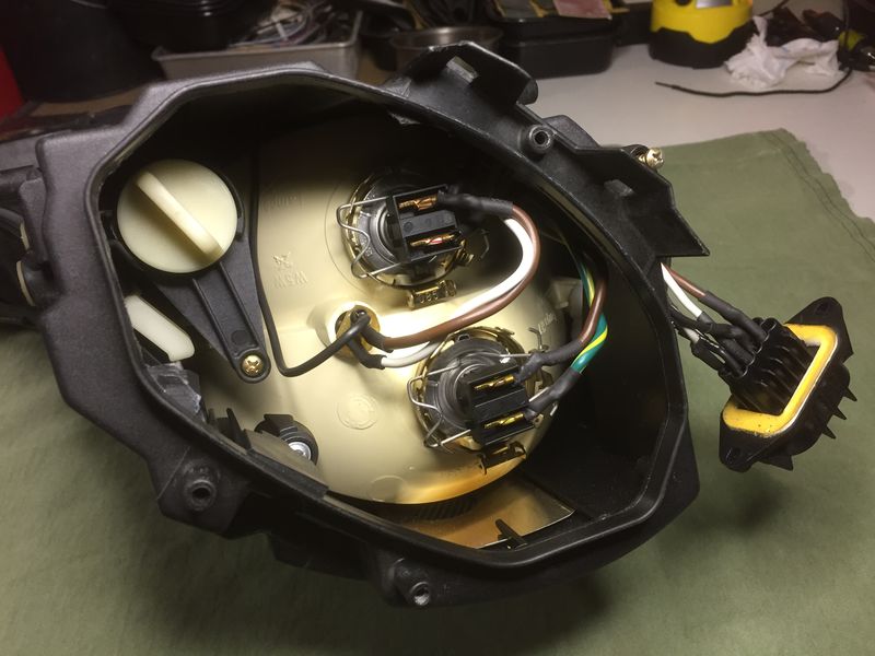

Correct! I'll give the PO a partial pass on the headlight wiring. This issue essentially left me stranded on a trip when I'd stopped for gas. I couldn't get one of my headlights to work and was running out of daylight to try to figure out what was wrong.
I'm sure the next owner of my car might not understand if they ever have to dig into the lights. I used liquid electrical tape and regular electrical tape to insulate the same wires. It's been over three years now without an issue so I can't call it a kluge.
Maybe your PO just used the wrong type tape but I sure understand what they were trying to accomplish.

Meanwhile, 4 hours later in the psych ward...|-)
Andesign is offline   Reply With Quote

Looks great! Hopefully no more issues. Weird thing for me was that all the bad insulation was in one light assembly. The other looked fine!
Old 03-19-2018, 02:02 PM   #10
Join Date: Mar 2018
Location: Winter Haven, FL
Posts: 7
Lol...This is the same headlight, my first attempt at a DIY re-wire, hence the psych ward remark...|-)
