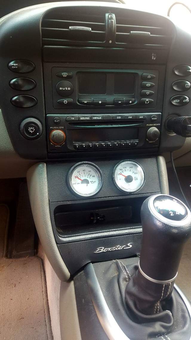

I used a VDO Ivory gauge from egauges.com.
