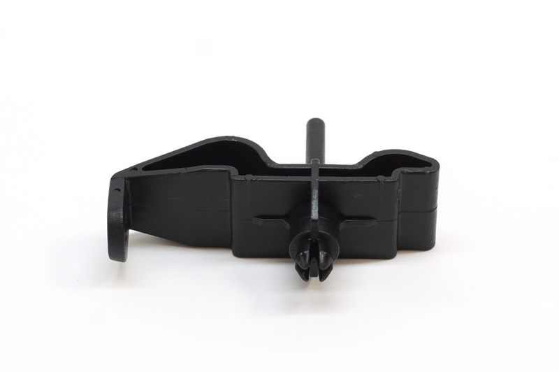

In the wheel well, rear driver side only. Nothing similar on the passenger side. Rod attached to an arm with wiring. Broken on the other end and I can't seem to locate where it should land.
I would have done a search but not sure where to start....

That is the lever that controls the Litronic HL position. It attaches to the suspension and moves up and doen. There is 1 in the front and 1 in the rear. Easy to replace and not expensive.

Thats what I thought as well but I don't remember seeing it on the rear suspension. Available used for cheap as well.

The part number is 996-341-371-03 front or rear.
