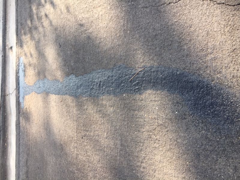

Pulled up to the house after running some errands and noticed some fluid from under the car as it was still idling. Initially, thought it was condensation from the A/C, but did not have it turned on.
Definitely coolant as per the photo. Enough to run down to the curb and pool.
Shut the car and then started her up and nothing...not another drop. Worth mentioning that upon start up I hear a high pitch whine that goes away after a minute or so.
Is this an intermittent water pump on the way out or something else? Water Pump was replaced 14,000 miles/3 years ago.
Any insight would be appreciated.
