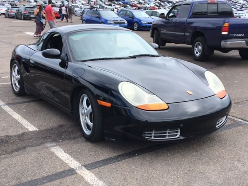

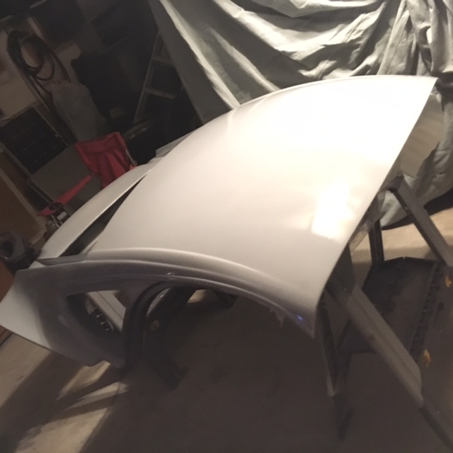

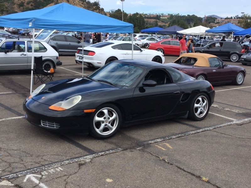

I ordered a Z-art top from Hong Kong a few months ago. Here are a few pics of where I am at so far. The top comes in two parts and it seems like they were made by different suppliers. The main (or forward) portion of the hardtop has quite a few imperfections and inconsistent symmetry. The hatch portion of the hardtop is incredibly well crafted for a fiberglass piece. (Please excuse the panel gap, my oem spin locks have not arrived yet)
I am still planning to wrap my entire car gloss brown metallic in few months, so the single-stage black (garage) paint job will get wrapped over soon enough.

Thanks guys. Yeah, I painted it myself in my garage. I have a decent hvlp gun and a compressor with lots of volume and a water/oil filter. It's not a professional paint job, but at least it's not too orange-peely, and will eventually serve as a good basis for a wrap.
If you get a z-art top I would plan for a decent amount of prep work because there are numerous little blemishes in the gelcoat. Also, keep in mind that garage paint jobs are never 100% dust free.

Looks great. Permanent install?
I am still fighting with every mm I can get for the hatch to have a perfect gap between the rear spoiler. And yes...there is not a single bit, which does not need detail work or modifications.
What glue did you use for the front and side window rubber sealings?
FYI...the windows can be adjusted underneath the doors. There is a rubber grommet which can be popped off. I think it is described in the Bentley service manual.
How about squeaks while driving?
P.S.: Cool exhaust tip
