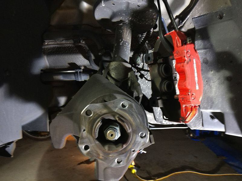

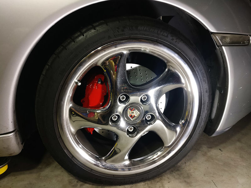

G2 caliper paint results
It was a rotor, brake pad, and caliper paint Memorial Day weekend!

Love the G2 caliper brush on paint, I've used it several times. Nice job. Now just order some decals up from eBay and you're done!

Love the chrome twist wheels

Not a whole lot of prep...just a wirebrush then some sandpaper. It's not perfect but you have to be a foot or two away to see the imperfections. Nobody is inspecting my brake caliper paint job!
I bought it off Amazon...this is the RED version. https://www.amazon.com/Temperature-Leveling-G2-Caliper-System/dp/B000AUMYMM

Por 15 makes a great brush on kit. Says 2 calipers per kit but I did all 4 and had paint left over. Very little prep needed on mine. Didn't have to disassemble anything, just masking. Paint is self leveling. Very easy job.

3. Was almost good with 2. Had enough paint left for probably 5 total coats.
