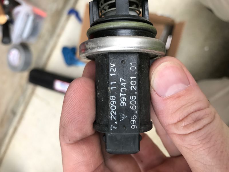

The valve attached to the carbon canister seems to be working, I removed the valve and applied 12V and Ground to the two leads. The valve actuates and closes the plunger/diaphragm. Are there any other things I should check?
