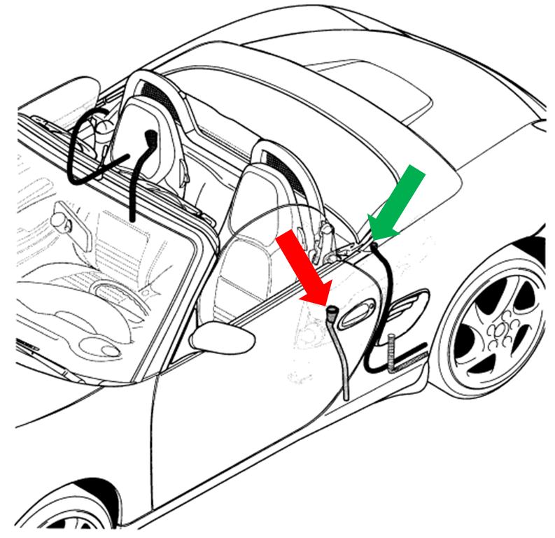

the holes you are talking about are marked in red in this pic.
the drains mmassey0125 is talking about are marked with the green arrow, and are located on the clamshell channels.
a bit hard to find, but you can get to it when the top is in service position.
Thanks Meir!
