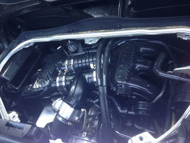

I use spray 9 ( citrus cleaner ) and a paintbrush to loosen everything up then gently rinse with water. I go over it with 303 protectant.

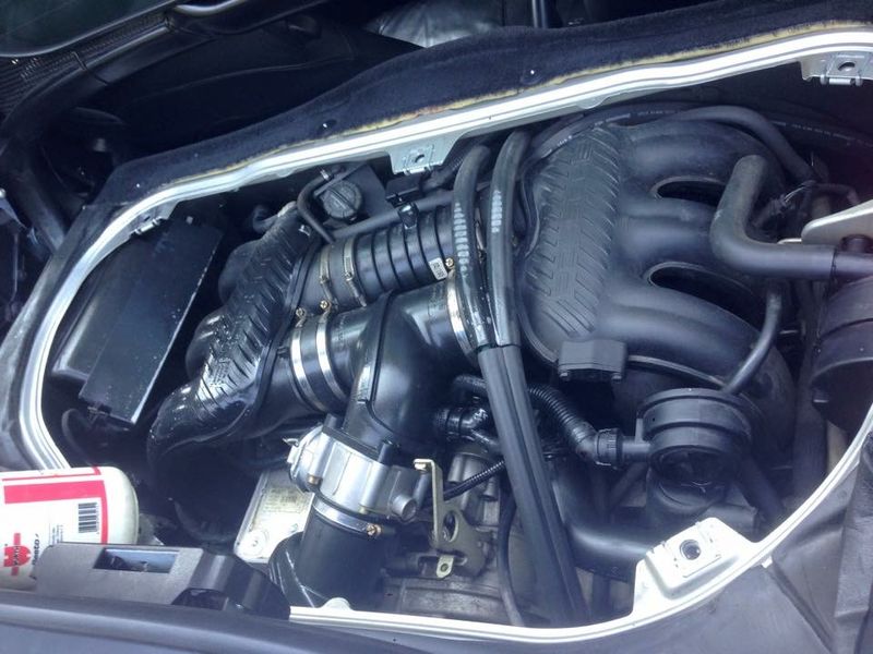

So the last time I cleaned the engine bay was may 2015
Changed my air filter today and here is how it looked
I simply wiped it down with a cloth and a bit of quick detailer
