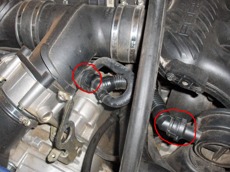

What is the purpose of this hose?
It is not on the technical drawings. It's not the hose that goes to the PCV valve on the drivers side. It connects to a hard line that seemingly has a sensor or wires at the connection then disappears with other hard lines. Where does it go?

I don't think that he is asking about the primary AOS to intake tube, but the secondary tube that branches.

Posts: 370
Yeah the secondary tube. Haha ooops should have made my post more clear!

Posts: 18
According to the Pelican "Boxster/911 engine swap" article (Figure #37) the blue line (in post #4) is the gas tank vent line, so it will be attached to the vapor canister. If that's the line you are referring to that is!

[QUOTE=RodJ;513179]According to the Pelican "Boxster/911 engine swap" article (Figure #37) the blue line (in post #4) is the gas tank vent line, so it will be attached to the vapor canister. If that's the line you are referring to that is!
Whooo thank you!
