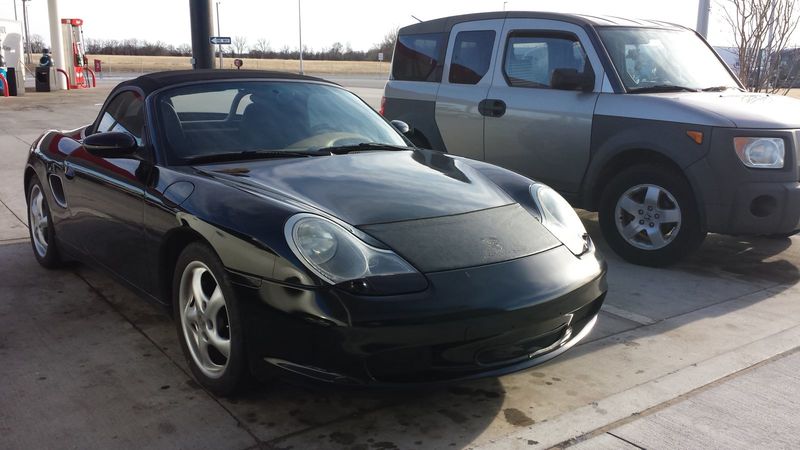

-Wet sanding for a partial respray to correct a run on the door:
Since then, I have done partial repaints of several other cars using the stuff I bought for that original job. I have not completely painted a Boxster yet, but I have done bumpers, a fender, frunks, and a trunk. Certainly not what most people have the time or desire to do. Anyone who wants to give it a try though, could find it fun and rewarding.
-Both bumpers, frunk and trunk repainted:
