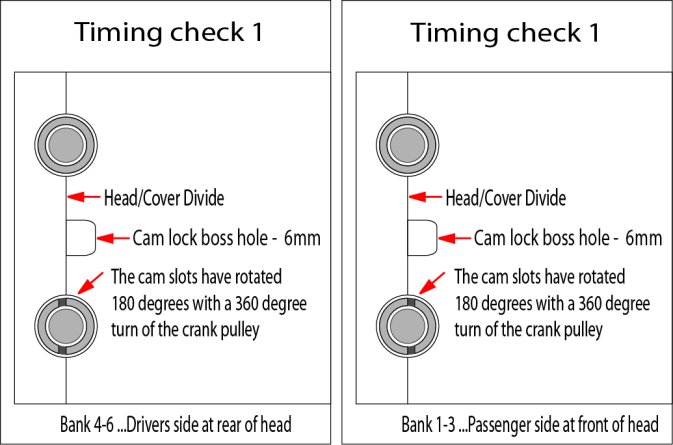

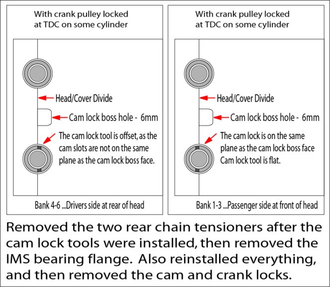

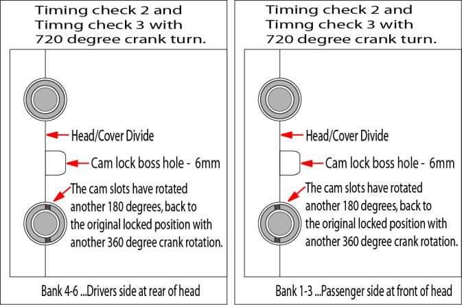

All the vibration and harmonics aside, I need to run this by you smart people...
I just reinstalled the IMS flange, reinstalled the chain tensioners, and removed the cam and crank locks. Do the following diagrams look as they should? I think they do, but just a little nod of approval would make it a great night!
Basically I am checking the timing on what appears to be a five chain system.

No idea on visuals above, can;t help. Those all look terribly complicated if you ask me (geez man). Hope someone here can give you a hand soon
