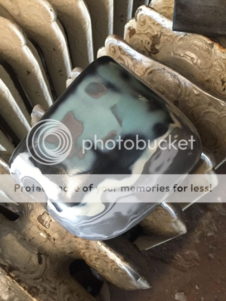

Thanks. I've painted it twice now and it comes out looking like my shop floor with paint on it.
Then a lump. Then a scratch. It's really not fun.
Another coat over the slightly lumpy spots.

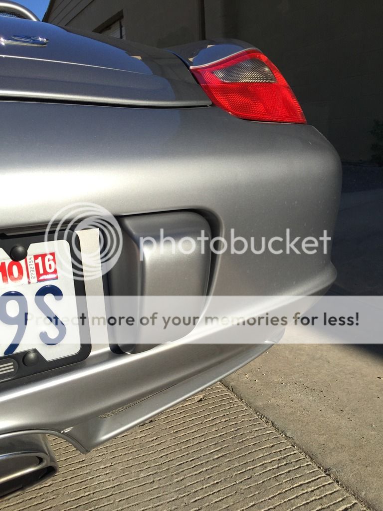

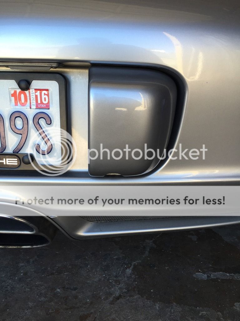

Finished. Looks almost shop painted in person. Fantastic results. The filler primer did it!
'08 VW Touareg T-3 wife's car
Old 06-04-2016, 03:28 PM   #14
Looks great! Nice job and way to stick with it.

Oh wow, that turned out great and looks to be a great match even for my seal grey. Can you post your exact parts list?
TypeA is offline   Reply With Quote
Old 06-04-2016, 04:46 PM   #17
I am my own mechanic....
Timco's Avatar
Location: Salt Lake City, UT
Posts: 3,432
That is GT Metallic silver. The special edition got a 911 color factory. NCS matched the paint in a spray can.
I'll get all product names tomorrow. It's all at my shop. Sorry.

Yo Woodie.
Thanks for that suggestion!!! It's the missing link! That's what happens when a boiler contractor tries auto body. That filler primer will make it look mint.
Appreciate that. Helped a lot.
Looks good and I'm glad I could help. That spray can paint doesn't have hardner in it so it won't be as durable as the factory paint. Not a big deal but you'll need to be careful with it and it will start dulling sooner than the other paint.
Woody

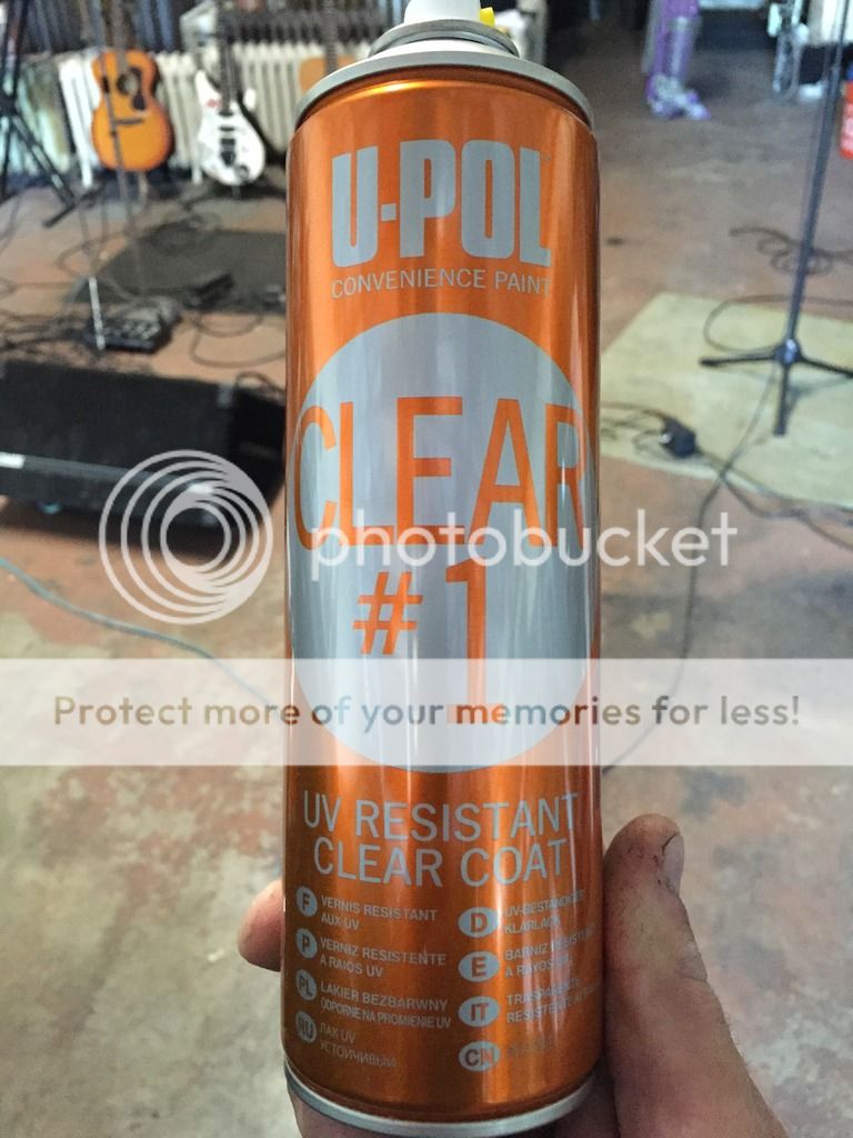

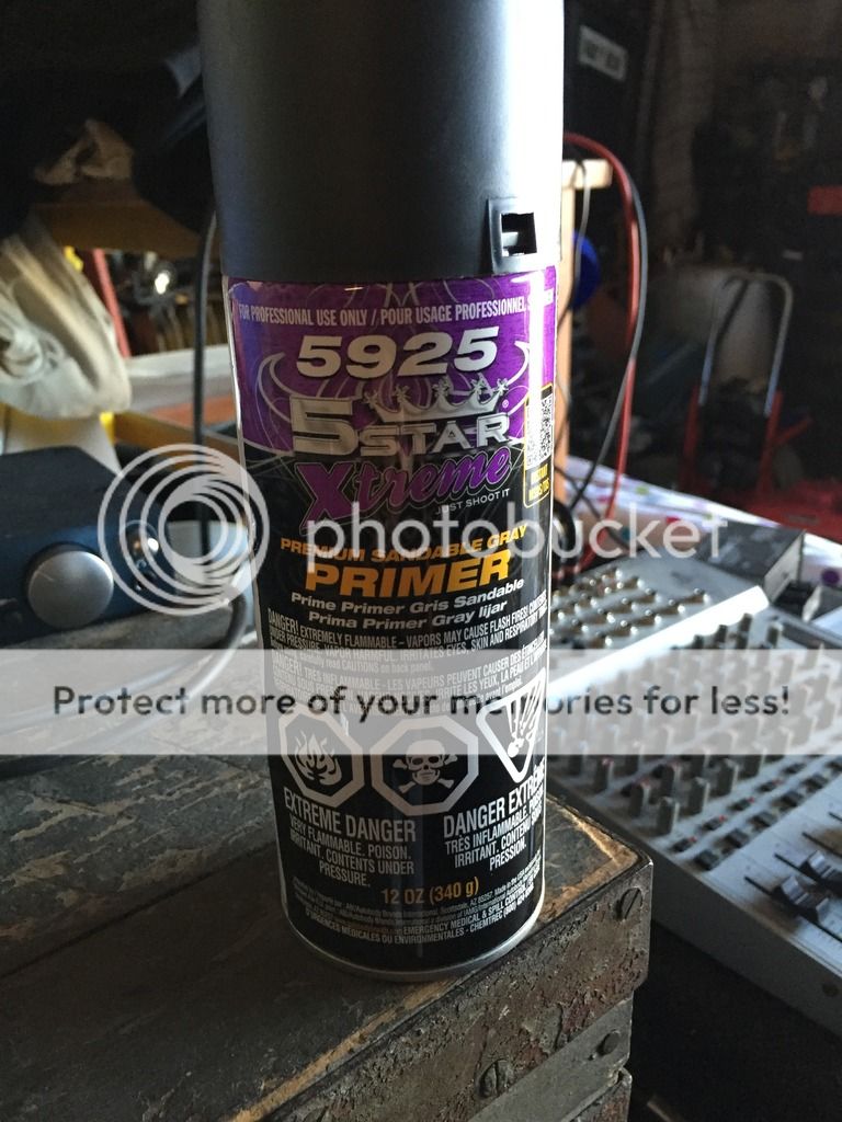

Old 06-05-2016, 07:43 AM   #19
Timco's Avatar
Posts: 3,432

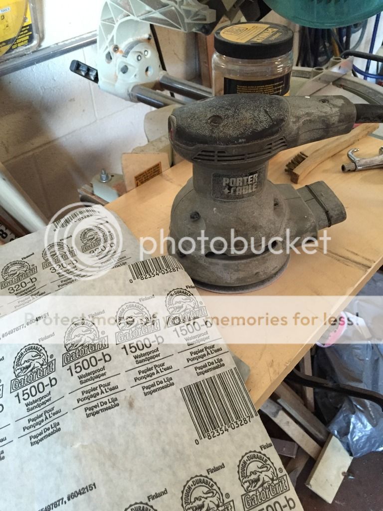

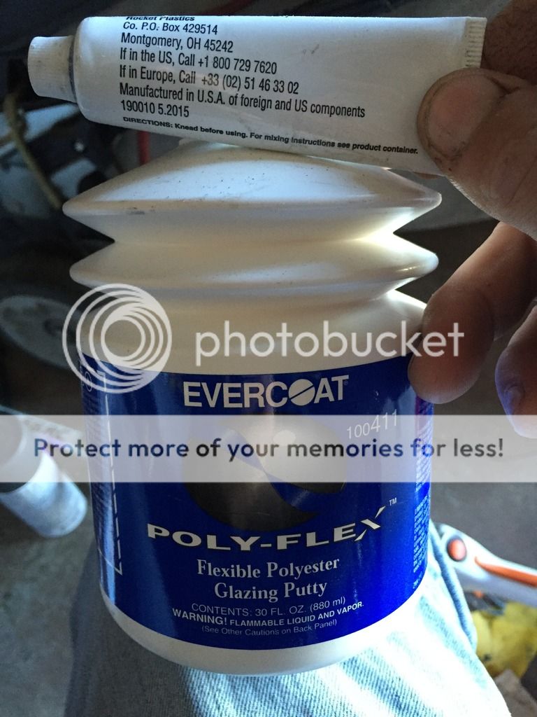

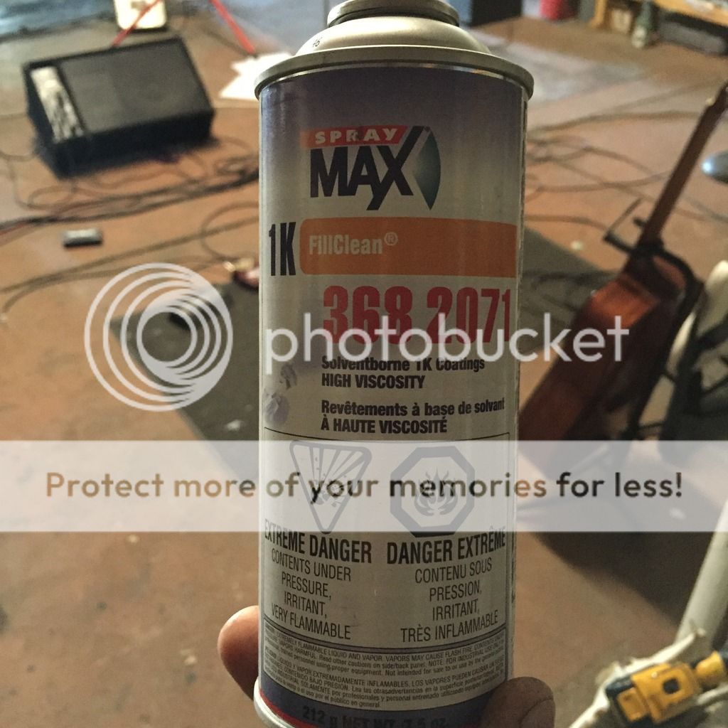

First step, sand down to rubber. Then add this.
Then sand with 220. The fine stuff is to sand the final primer.
Then the filler primer.
Then paint. DO NOT let it run. Two even coats.
Then clear coat.
Done.
