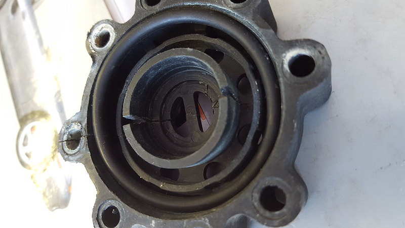

Cooked it at the track!
Came out of a hairpin and went WOT into a lovely spin! WTF? Seems I slipped on my own coolant which was pissing out of the overflow (brilliantly placed just in front of the right rear wheel!
On checking that out, I find that there is oil all over the top of the engine. And my power steering fluid is rapidly leaking from somewhere...

AOS failure. Leaking boots on the intake cross tubes. Coolant purge valve brittle and cracked big-time. Other stuff to keep me busy and poor until my next event!

It was on my third run. Missed the last run and all of the 2nd day.
Actually, I knew I had a small power steering leak, but I have yet to locate it.
I changed out the AOS today and replaced the coolant releif valve which was completely shot!
This is only 2 years old!
