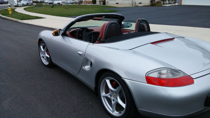

1999 Boxster - bought sight unseen and have some questions
First off, been lurking for the better part of 30 days and have found the site very informative, great community here!
I bought this gem on a whim and showed up to pick it up without having ever researched anything about these cars and spent a whole 10 minutes looking it over, sufficient enough time for my wife to not be able to change her mind! A P Car, of any kind, has always been a dream for me, so this is a nice place to start.

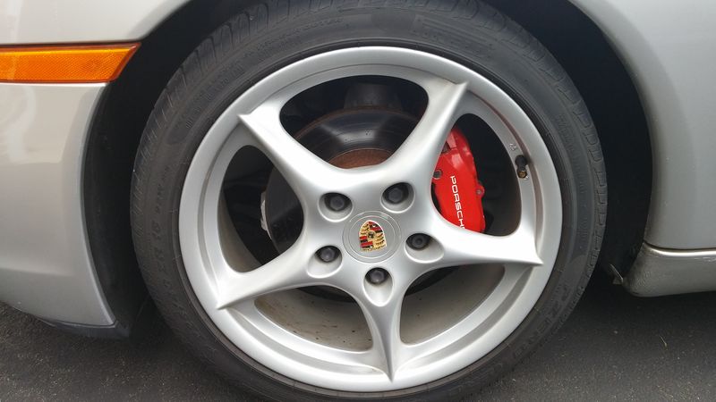

So.... that said, I know there are a few modifications/changes that have been made to the car and I'm looking for some help in identifying them. I want to be able to prepare for appropriate maintenance and also would like to explore a few different options, the wheels (which I believe are BBS Carrera III, if I've researched right) being my first change.
Questions are mainly on the wheels, brakes and suspension.
- Would someone be able to confirm my ID of the wheels?
- Are the brakes S upgrades and how to easily tell?
- Lastly, the car looks lowered. Thoughts?
Have put about 200 miles on the car, drives nice and tight and has a great sound. Would like to get some PM out of the way and looking for suggestions on where to start.

Chris, that is a fine looking car with a nice colour combination silver and red. Interior looks pristine. The wheels look like Porsche Carrera II to me, same as on my car. Why would you change them?. They are about as good looking wheels you can get. Also very easy to keep clean compared to multi-spoke wheels. Those look like S calipers but on non-drilled rotors. As far as lowered, the angles of the photos don't lend themselves well to determining that.

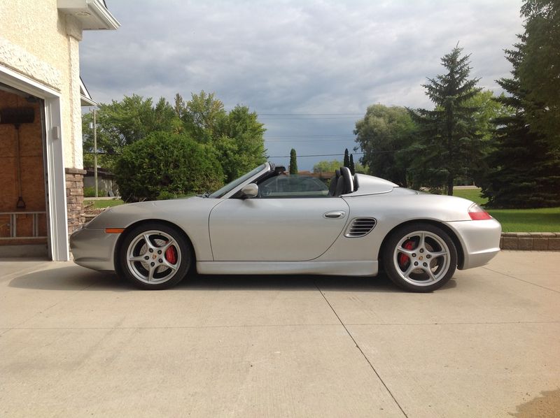

This may help. Here is a shot of my '03 S straight on the driver side. Mine is not lowered.

Those are base brakes painted red.

Great looking car. Previous owner also put facelift taillights on. I think some clear side markers would be a nice touch as well.
Also +1 for keeping the carrera wheels. I think they're one of the better looking wheels for this car period. Shine them up and enjoy!

Those are C2 wheels and were an option. I agree, they are some of the best looking wheels and much easier to clean than most others
Was that car sold as a S or Base? As it is a 1999, it can't be a S.
It appears to have the 3rd radiator, which only comes from the factory on a S, but can be added later as well on a base. It has a 4 spoke wheel and the older shift knob where did not come on a S. It also does not have Boxster S badging on the door sills or the batwing. It also has black trim on the windshield which came on a base, a S has titanium colored trim
While the S brakes are painted red, someone could have repainted other ones red. You would have to look at the part number on the caliper to be sure
My guess is you have a base that someone did a few "upgrades" to look like an S
If you post a pic of the VIN/option label, it would give some insite to what you have
In any case, it looks like a nice car, have fun with it.

i would also say these are base breaks with red painted calipers. The front S brake discs in the ront are vented and have drills. Also the discs are a bit bigger (310 mm diameter). The rear brake discs on an S are also drilled and vented.
To me this looks like a base model with some S parts.
Attached picture shows S front break.

The wheels could also be reproductions. Do they have a part number near the valve stem?
