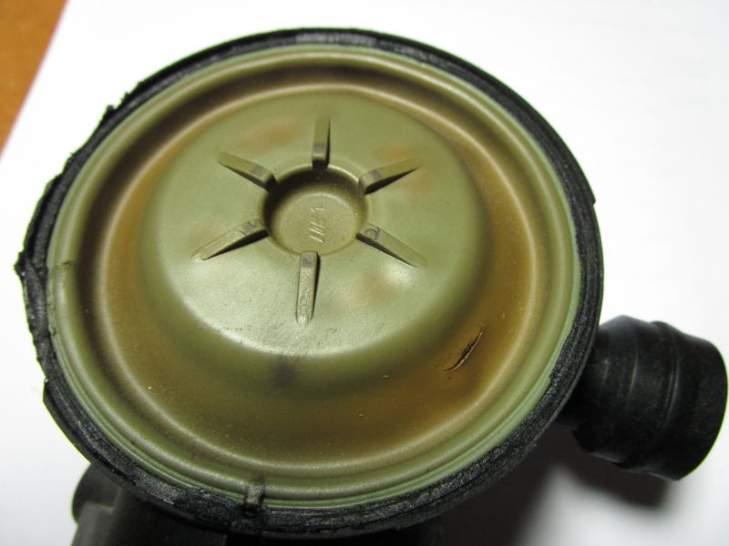

Old 05-04-2016, 06:50 AM   #9
Join Date: Jun 2014
Location: Spokane, Wa
Posts: 24
Here's an example off what usually fails with age. Notice the diaphragm split.
