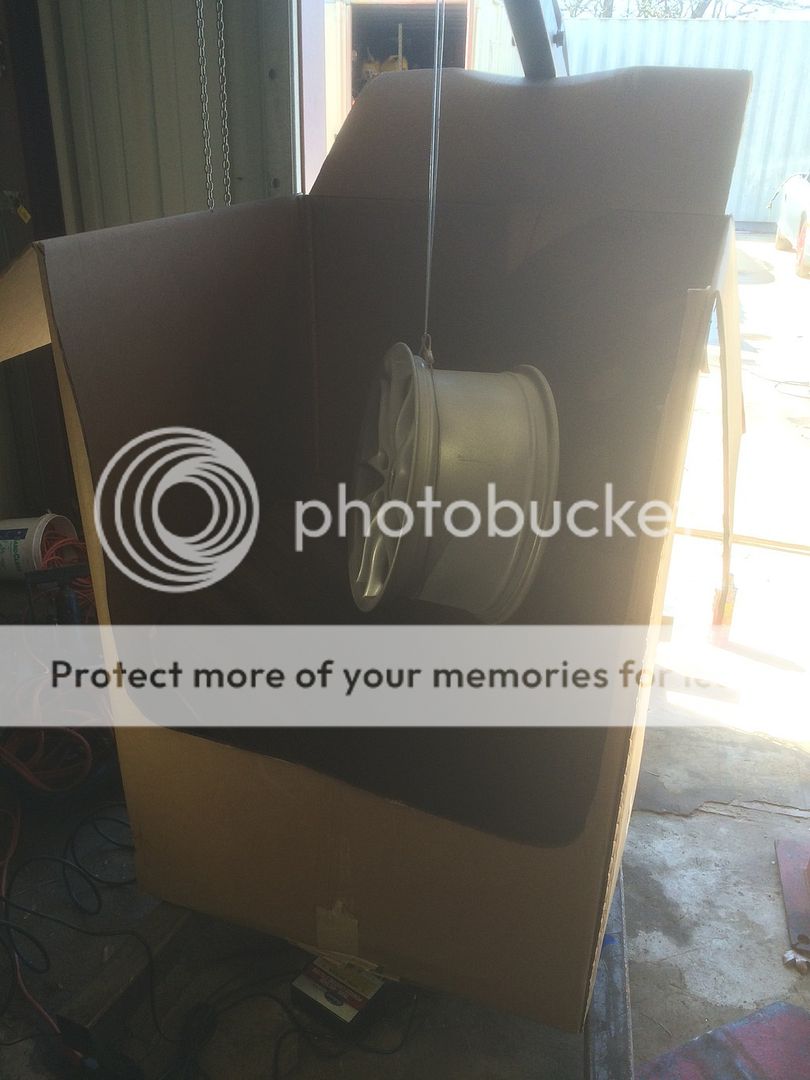

I'm not afraid to try new things, especially if I can save a buck doing it myself. I've been very successful at learning how to do things for myself and take pride in my DIY ability. It's who I am and the reason I'm able to do what I do for a living. Most things aren't that hard to do once you learn how to do them. So many people are afraid to fail and I don't get it. So you messed up. Keeping trying until you get it right! Well, I'm getting tested on that motto. I've always wanted to try powder coating ever since they came out with those at home kits. I finally bought myself one of those kits and got a oven. I got the oven for free from a friend who was remodeling her kitchen a few years back. It took me a few months to finally find some wheel to powdercoat and a friend of mine wanted to also try on his spec boxster wheels. It was a learning experience for both of us.
We started out by getting the wheels sandblasted.
We took this wheel
And hanged it in the spray box like this

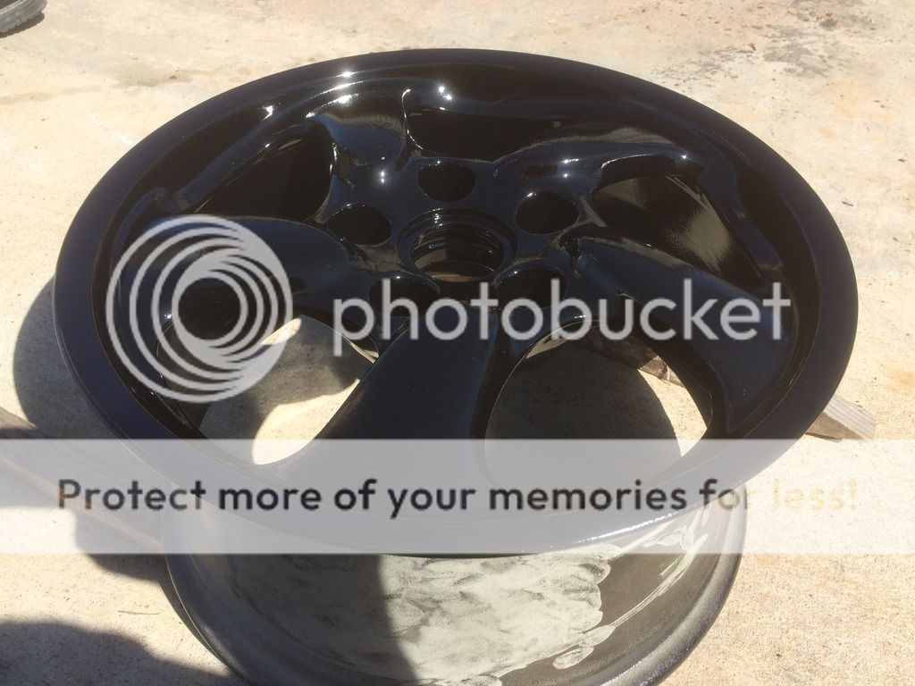

This is how it came out of the oven
If you look hard you can see lots of flaws in the finish. We tried first on some scrap metal but probably should have practiced more before moving onto wheels. Getting the powder in the lug holes was very difficult. We did one wheel and called it quits. While we were defeated, we weren't done with powdercoating just yet. The conclusion we came to is that it might be best to let the professionals do larger objects. I have a set of calipers I'm going to attempt next.

That looks like impurities in the base metal coming up or the surface just not cleaned properly. You need to pre-cook some stuff to get them to gas off as well. Let them cool and then powder coat.

Thanks for your help guys. The coating had covered up the pre-blemishes pretty good. Most of the finished blemishes look like fisheye or orange peel. A lot of that was caused by me trying to get powder into the lug holes. I should have started with the hard to reach areas first and then a final cover of the powder. I had cured the wheels the day before and that might have a little to do with the blemishes. We had a few things working against us. First, the sandblaster didn't do that great of a job. We didn't cure and clean them good enough. Our ground wasn't that great. Moving from the spray area to the oven was difficult. The oven was too small. I couldn't even fit my 18's in it. The oven temp was questionable too. We had two digital thermometers and they both were reading differently. You can tell when the powder has set because it will get glossy, and then you bake for 20 minutes. But it was still a guessing game on the temp. My friend wants to borrow my equipment and keep trying. My cheap Chinese 18's wouldn't fit and I'm hesitant subjecting them to that heat, so I'll be painting mine. To answer Steve's question. Powder coating is so much more durable than paint. It's not bullet proof and it has it's cons, but it's better than paint.

Been powder coating at home for years now. Those wheels being aluminum would've benefited from prebaking. Aluminum is porus and tends to absorb grease, oil, and all kind of bad things. I typically prebake them for about 30 minutes at about 450 then cure them at 400.

I also read that there is another technique when you don't have the electrostatic powder sprayer.
You bake the part uncoated first and then take it out and immediately spray the powder coat but being carefull no to put it on too thick.
It melts onto the part immediately and then you still need to put it in the oven again to complete the baking process.
Doing it this way solves the problem not having the static electricity to hold the paint on the part initially.
This technique also helps with aluminum parts to reduce the out gassing that occurs when baking as the part is already hot and out gassed BEFORE you apply the powder coat and reduces the bubbles, orange peeling, fish eyes, rabbits feet, wolf bane and other assorted things ending up in your finish.

I know its digging up an old thread, but I too got the PC bug this year, and the first thing I learned is even with a thorough sand blast and cleaning, its VERY important to clean all surfaces with pure acetone, even after pre-baking, (pre-baking is not a necessary step imho). Wipe all surface twice with a lint free rag, high pressure air to get rid of any lint or dust, then apply powder or manufacture recommendations. I follow these steps and get desired results, though I haven't tried rims yet.
