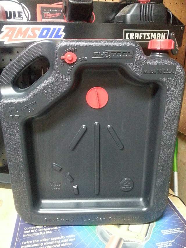

Oil change drain pan
Anyone that does their own oil changes on these cars knows how fast the oil comes out. They also know the large amount of oil these cars have in them. I have tried a few different catch pans in the last few years. The one that worked out the best so far is a 15QT pan I modified with a bigger hole and some wire mesh. The main problem with this pan how full it is when i'm done. It makes it hard to pour the old oil back into the jugs without making a mess. Well I picked up this new 16QT pan from walmart the other day. I haven't used it yet, but this looks like it will work like a charm.
16qt Oil Drain Container - Walmart.com
This is the old pan I used

I've got that same one, just recently got it, haven't used it yet. Looks nice, I will change my oil in a few weeks and report back unless you beat me to it

That oil inlet hole looks like it may be too small to allow the oil to flow fast enough into the container before the level overflows the top. Hopefully that is not the case. I just use a conventional open oil container, it easily has taken oil from 911's , 914's , my diesel truck which have all contained 10 - 12 quarts per pop.

I've had both of those containers for my F-250 diesel truck that holds 15 qts. of oil. I have the 15 qt. round one and the 16 qt. square one. I've had problems with the caps on both. The pour cap that you use to drain the oil from the round one leaked. They sent me several replacement caps. They all leaked too. On the 16 qt. square pan, the vent cap constantly pops open by itself. Poor moldings. I'm going to contact FloTool about that issue too. They need to get their act together.
No problem with overflow though .

I have the 15qt round from walmart. works fine for me but I undo the drain cap so the air can escape I also usually put a piece of cardboard underneath cause you do get some splash. You gotta open the drain spout so air can escape or the oil wont flow into the drain pan fast enough and it will overflow. I don't drain back into the jugs I just take the black container to the landfill and empty it.

Well the main difference between the pans is that the 16QT one seems to have way better seals on the caps. The 15QT seal on the pour spout is horrible. Also the hole for the oil to go into the pan is way to small and doesn't seal. I ended up making it bigger and covering it with wire mesh. The vent cap is the least of it's problems. The 16QT also can be stored on its end, that is if the seal in the pan part works.

Well, I've used it twice and I can report my findings: the hole in the middle for the oil to go in is big enough, and with a vent cap that won't stay closed, you won't be storing it on end, at least not when there's oil in it. The guy I talked to at FloTool said that the replacement vent cap would seal tighter. We'll see .
The 16QT one i'm talking about has the vent cap on the top if it's standing on end. Check the pic in the first link I posted. (the walmart link).

I don't see how the vent cap leaking would even matter if I stored it like this. Not that I plan on storing oil in it anyway.
