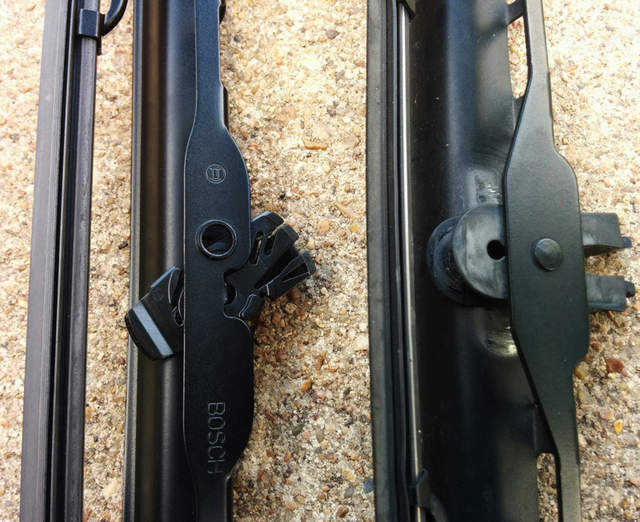

Why do they have to redesign something that works? Wipers won't fit.
Bought new wipers. Passenger side is the same latch and fits fine. Driver side - nope apparently they just had to re-design for whatever "improvements". It won't snap securely. Sigh
Original on the right. Vastly improved design on the left.

Okay am I the only person that can't seem to find wiper blades that will fit my car? 6 months later I'm trying again and can't find blades that will fit. The wiper set I bought from Pelican...passenger side came with the same connecting system but the drivers side is different. The corresponding model numbers of Bosch at Autozone has the different connection.
I just want a drivers side blade that has the original connection! (the right side in the 1st post picture)

@Patssle...if it makes you feel any better, my wife went to O'Reilly, bought the Bosch Icon's and attempted to attach them on her (my) 97...The j-hook on the shaft apparently did not fit into the mechanism on the new blade, so, while she had the arm up and was trying to "finagle it", it, she bumped the arm and it fell onto the windshield----yep, 3 cracks about 2 inches long. I was a happy guy...broken windshield, and no wipers. they do not fit the drivers side.

...I bought OEM blades from Pelican and they would not "Click" into place, either. After carefully examining them, I ended up working them with a nail file in order to get the length on the tab short enough for them to "click" engage and lock into place. What a freaking weird deal.
It worked, and they are fine, but I'm going aftermarket next time.
