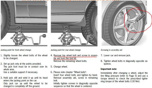

Simple, use the guide pin.

Is the guide pin in the tool kit ?
Old 06-07-2015, 01:39 PM   #6
Steve Tinker's Avatar
Join Date: Dec 2008
Posts: 1,522
^^^Yes ^^^
Even using the one guide pin in the tool kit can be a bit questionable if you want to avoid scraping your freshly painted calipers. I bought a second pin which helps locate the wheel square on to the hub - two are definitely better than one.

RedTele58's Avatar
It should be. Here's where mine is- right in the center.
