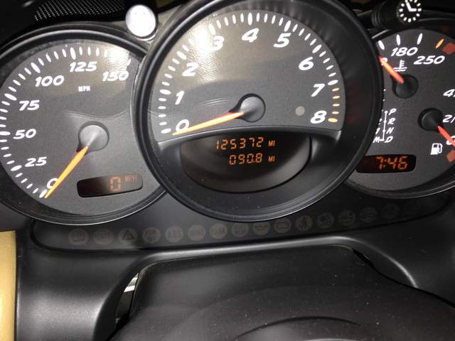

To illustrate what I was saying above, here are a couple of pictures:
"Old Normal" operating temp
"New Normal" operating temp
and it will get a little higher than that.
One other data point. This morning, I got stuck idling/crawling in traffic behind an accident. Outside temp was about 75F. While I was sitting, the temp spiked up beyond that second hash mark; the needle was going through the 2 on 250. It took about ten minutes before this occurred, but it when it did happen, it wasn't gradual, it happened over a couple of minutes in a couple of leaps. I've never seen it that high. The moment I started moving again, even slowly, the needle came back down to the new normal.
Should I be concerned?

That is the exact temp difference I see winter to summer and I have a low temp stat.
Going to check rads but that's the exact swing I get.

Here's a couple of other thoughts.
1. The front fans have 'ballast' resistors in their circuits. If these fail, the fans will not operate in low speed and assist in cooling. You can test these in the following way. With the engine cool, start the car with the AC on. You should hear the fans running in low speed on both sides. If not, then you either have a failed ballast resistor on the side the fan isn't running or a broken fan.
2. When the car gets hot, do you ever hear the fans run in high speed. If both fans don't run in this mode, I would suspect you have a bad temperature sensor in the cooling system. If one comes on and the other doesn't, this might be a clue that you have a broken fan on the non-running side
3. You might have air trapped in the cooling system after the refill when the water pump was changed. Other post suggest how to bleed the system.
4. Is the amount of fluid in the tank staying at the same level? If not, it could be lowering as trapped air releases though the value. Or, it could be you have a leak somewhere in the system. A pressure test will help you find out if this is the case.
Hope these ideas help

Thanks everyone for the input. I have been searching the forum for similar topics, and have learned that I need to check/clean the radiators, etc. Though, you'd think my mechanic would have checked all of that when I first took it to him asking him to check out the cooling system.
Thom, to your points:
1. Yes, I've tried this test and both fans come on
2. Yes, I definitely hear the fans run at high speed
3. I thought about this possibility, though this all started before the water pump was replaced. Still, can't hurt to try this.
4. I'm not sure, its only been a day since the water pump was replaced, though the system was pressure-tested about a month prior to that.
Thanks again for everyone's input, I'd appreciate any additional insight.

I would not be concerned, but rather be prepared to replace parts. My 02 was running hotter than normal, like yours just moving gradually beyond the 8. Never near 250 though. Mine was the water pump slowly failing. The pump finally began to regularly leak fluid after sitting a few minutes after being driven.

Yes, I saw that video, which is what convinced me that I can probably handle the job myself! If that doesn't make a difference, I think I'll have the system bled.
I believe the test for low speed operation of the fans is to turn the AC on when the engine is cold and see if the fans are blowing under the front of the car, correct? If so, then yes, I've confirmed they run at low speed.
Yes, this problem started a month ago, then the water pump went earlier this week. I thought that replacing the water pump would return everything back to normal, but so far, no.

One additional data point: since the water pump change a couple of days ago, the car seems to get to temp much more rapidly than it did in the past. That, and the way it spikes up at idle, has me a bit freaked out.
Anyway, the input I've been getting here is leading me to believe that I need to have the system bled. I'll clean the radiators this weekend, then take it to the Porsche specialist next week.
