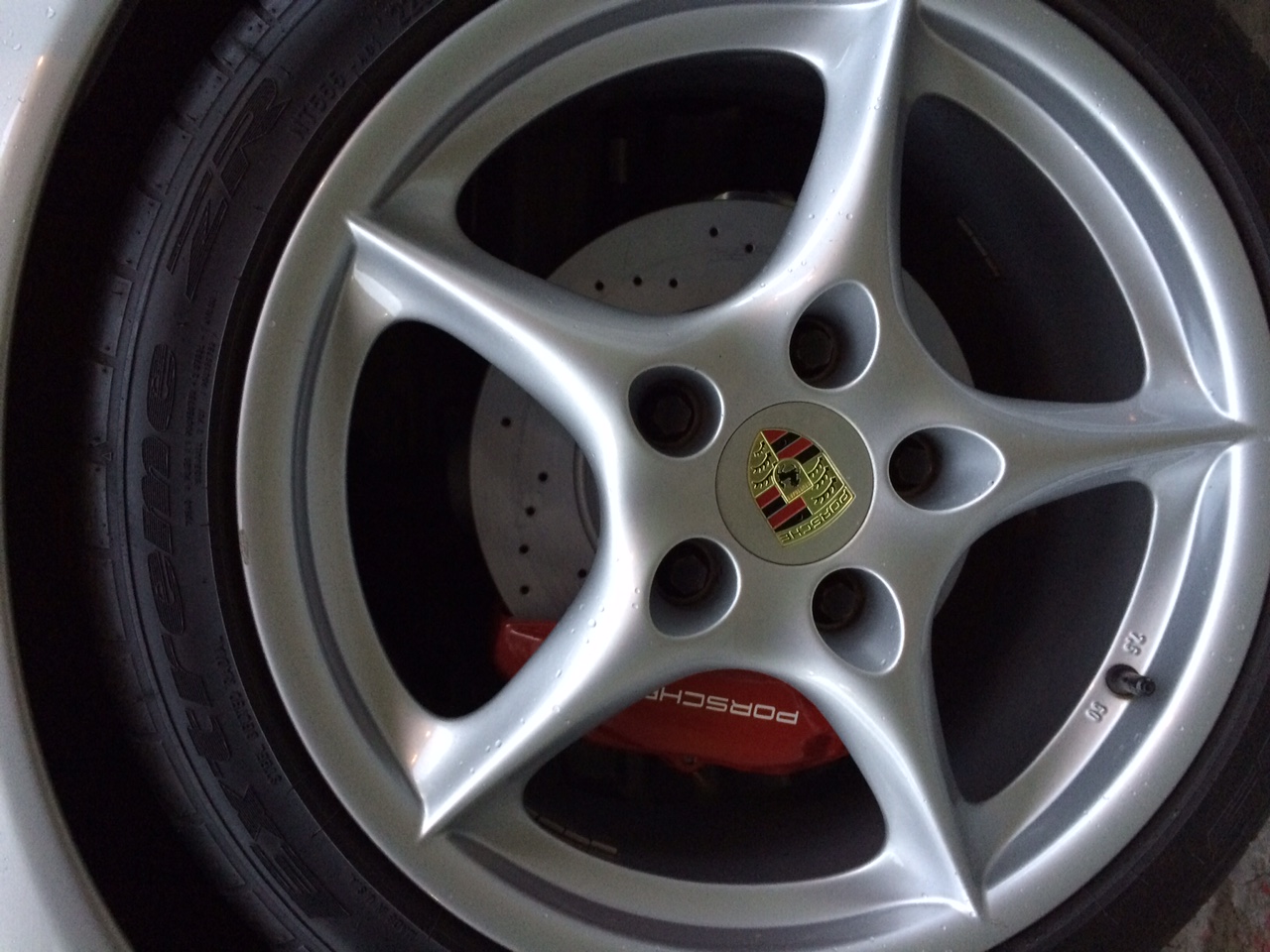

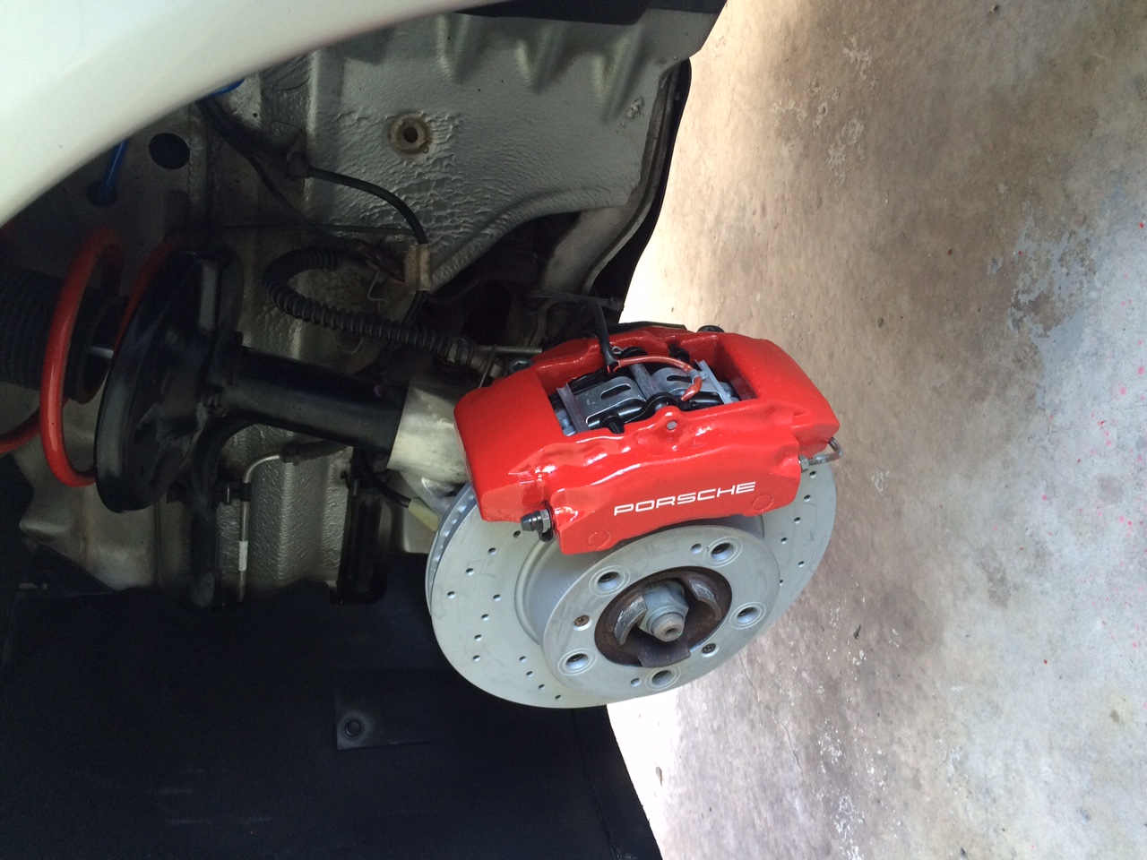

Did my front brakes , could not believe on how easy it was. thanks too all the info. on how too on this web. site. Saved myself $1000's from dealership. Painted them red too!! and a shout out to Pelican auto parts for fast,easy order online.

Thanks all.Brake rotors are the Zimmermann Coat Z Cross-Drilled,Pads Textar and Oem senors.Everything fit on with no problems.Price came out to just under $560.00Canadian + shipping to Canada from Pelican parts.Dealership here charge close to $1,500 for fronts.Drive's really nice now.Old fronts lasted me almost 8 years since i bought car.You can work the clutch/gas and brake smoothly with out much effort heal/toe like a race car action.Just drives so much easier in traffic,if that make sense,just less effort .Painting was a ******************** using the brush on Dupli-Color paint kit.I think it was a bit to cold still here in Canada to dry.Had to wet sand twice +repaint to look some what factory and still not looking in real life the best.Thinking sanding/repaint again in some area's.Cleaned up/washed the wheel wells/ under body too while up on jack stands.

How did you get the Porsche lettering on the caliper?
It's a decal. you can get them from Ebay.
That's a very nice job indeed for a brush-on finish. I sprayed mine with VHT. Four coats of paint, applied the decals, and then two coats of clear. I was quite pleased with the result.

I plan to change my tt brakes soon. What torque value did you tighten the calipers to?

Hello, thanks again. 63foot pounds. Paint.. i just tried to follow instructions on box.I will make a video when i do the rears on how i painted them.

Hi, i still have half a paint can left over. There is lots for 4 Calipers. I pretty much did 2 coat jobs.Had car on Jackstands for 2 weeks. First coat let it dry after five days then wet sand with 800grid to get paint even ,then 1500grit to smooth out just bye eyeing it, getting the paint to look even all around.Then repainted it again. Was a pain painting these with this paint. After 48 hours,lightly wet sand with 1500 area's that needed it, put decal on, then sprayed the clear light coats. Was like oh man ,the paint started to bubble get soft. Didnt touch,after hour the bubbles went away and made the paint look even smoother.? oh well. Gave it that oven baked look. That paint brush in kit is just garbage.brushes came off painting.
