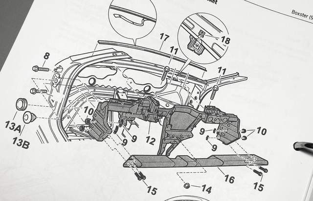

I'm in the middle of stripping down the car, I need to remove the dash bar, wiring harness and hvac etc. The bar is loose but its still attached to the fire wall. I would like to pull the bar with the peddle assembly and steering column still attached, is this possible?
This diagram may be helpful:
