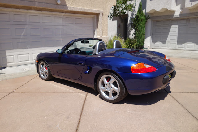

BTW, here are some pics of my new ride.
2001 Porsche Boxster S 6MT
