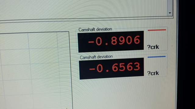

Hello JFP,
Somehow I am concerned with the position of the decimal point, does this picture looks Ok with you?
Gilles is offline   Reply With Quote

I have never seen 4 decimal places. Durametric software could be doing fancy things with the cars reported value like rounding to different places depending on the reading. a <1 degree reading might report 4 decimal places, but thats the only reason I can think of why it would change reading to reading.
What year do you have?
Also, runjmc, are your readings 6.0 and 3.0, or some other decimal value?
Epapp: My car is an '07 Cayman S

interesting...
Something tells me the amount of precision has increased with newer engines/MY/ecu software

Hello JFP,
I would not be concerned, the late software versions tend to go out further in decimal places as you approach zero.
JFP, Thank you for the confirmation!
