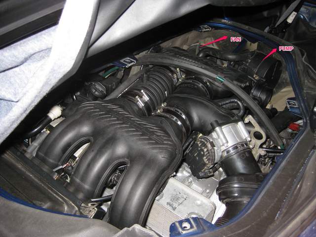

So the air injection pump is located near the cooling fan behind the passenger rear vent?
Is it hard to get to? Topside via engine cover or bottom side thru wheel well?
is there anyway to diagnose the fault definitively before actually replacing the part?

Old 11-23-2013, 05:23 AM   #10
pjq
Join Date: Dec 2010
Location: Eastern canada
Posts: 262
Top right behind passenger seat, check out pic.
