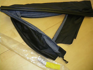

Looking for a little help on the installation of this part.
The car is new to me and this was found laying in the bay for the convertible top. It appears intact and web searches identify it as a protector of sorts but i'm baffled. There is a plastic clip on it that may connect to the soft top and two straps that fit somewhere. If anyone can shed some light, it would be appreciated

That looks like the shroud that goes under the rear window. you have to lower the top partially into the service position so that the clam shell exposes the area under the soft top.

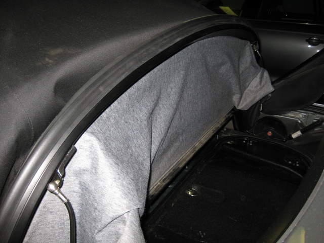

The top edge is held at the back of the top by the wide plastic bow that goes all along the back of the top. It looks like the bow is held on by a couple of screws at each end.

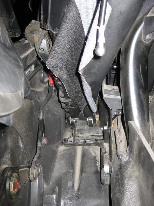

The sides of the bottom are held here (left side shown):
The long plastic piece at the back pushes up into a clip at either end at the back of the top cavity. The intention is that water run off of it into the foam catch trays.

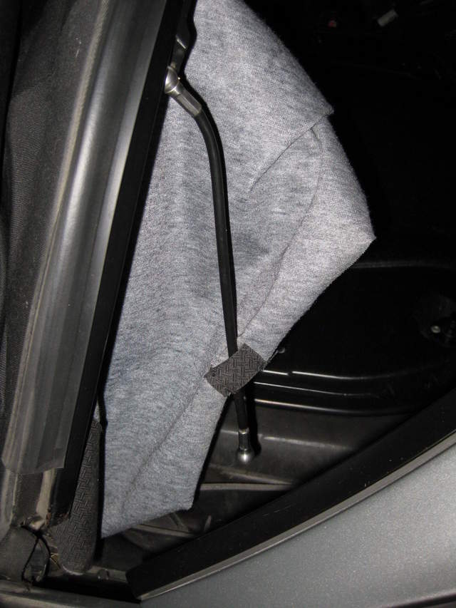

Note the routing of the two top hold-down cables thru a loop on each side (left side shown):
