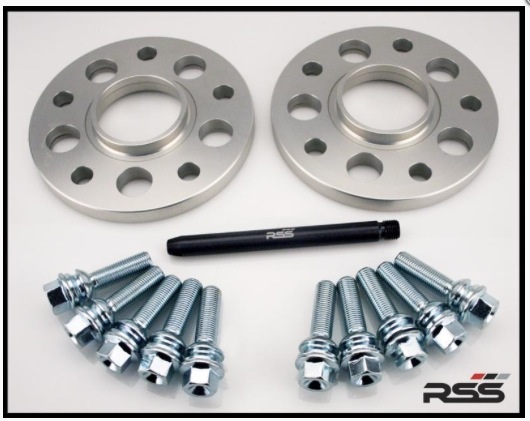

Ready to purchase these, would these work with my wheels? Assuming I use a 5-7mm spacer.
Mcgard Audi Porsche VW Chrome Wheel Locks Lug Bolts | eBay
Johnny Danger 10-06-2013 06:26 AM
You want oem 19mm (head) ball seat lugs bolts. Don't mess around with these kinds of multiple fit lugs.
Nine8Six 10-06-2013 07:31 AM
Nope those won't work and like JD mentioned, do not try you will crack your wheels and potentially worst.
What you need is the ball seat lug bolt with a R14 (ball radius). Nothing else
Touch The Icon 10-06-2013 10:45 AM
Thank you Johnny and Nine8Six for your quick response. Could either of you provide me with a link for the correct set. It's been real tough to locate, especially when you arent mechanically inclined like myself. The bolts I posted have the r14 ball radius that you mentioned in the description Nine8Six. Are these still incorrect? Thanks guys :cheers:
Johnny Danger 10-06-2013 04:18 PM
Find a seller online or get them at the dealership.
Touch The Icon 10-06-2013 07:41 PM
I found these in a previous post by Johnny. Just purchased this set. It's a much better spacer then the one I got at the tire shop and its 7mm vs 5mm.
http://986forum.com/forums/uploads01...1381113615.jpg
Nine8Six 10-06-2013 08:14 PM
You are right, missed the desc "Seat Style: Ball Seat 14mm Radius (R14) With Spin Seat Design". From the picture they appeared to be something different. Late night, red eyes and all..... Apologies.
The spacers above and lug bolts seems to be fine. Actually I just browse at this eBay seller's stocks and I'm thinking about going for a set of his 'rust proof' black zinc plated lugs myself - I could get rid of my cheap black plastic caps I'm using to hide the OEM crappy & rusty lugs that Porsche puts on their cars.
Thanks for the link ;)
