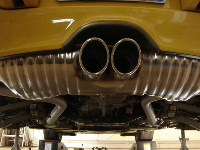

Here is the same set-up I have on my old 911, great sound without a hint of drone:
