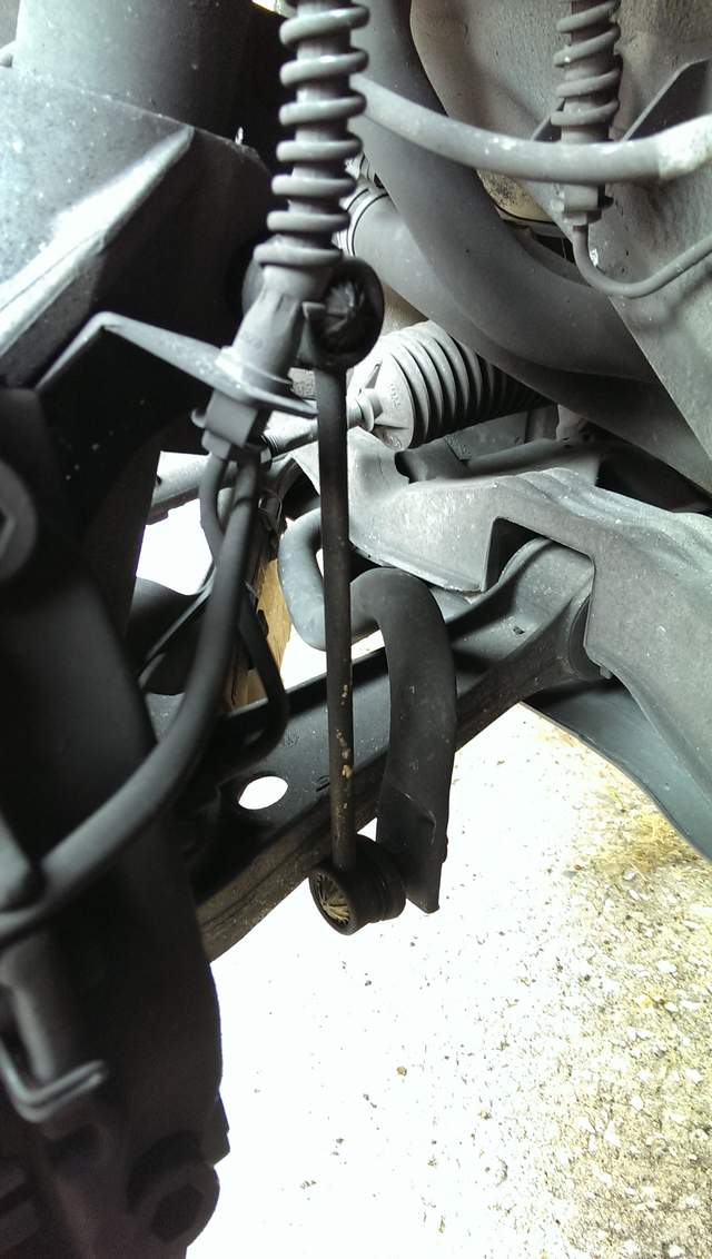

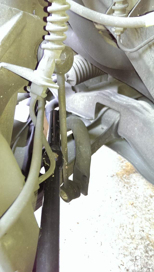

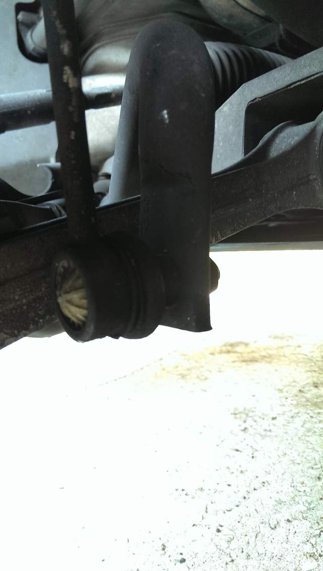

Am I looking at the right thing? I've attached pics. Also am I doing the pry bar thing right? Also attached pics of that.
The way I did it there didnt seem to be much play in the bar. The thing its attached to on the bottom move a little bit though.
abuzar1 is offline   Reply With Quote

yeah, that's the drop link alright. try putting the prybar end between the link and stabilizer bar. if you can in way make the joint move in or out, it's bad. if it's original with any miles, I'd say it's probably bad regardless. one side of mine had like a 1/2 inch of play and made a nasty knocking sound on bumps.

A worn drop link is usually visibly offset and yours look ok so far. If you get your car up on a lift, start poking around and testing suspension components like struts, A-arms, and see if you can locate the rattle problem.
