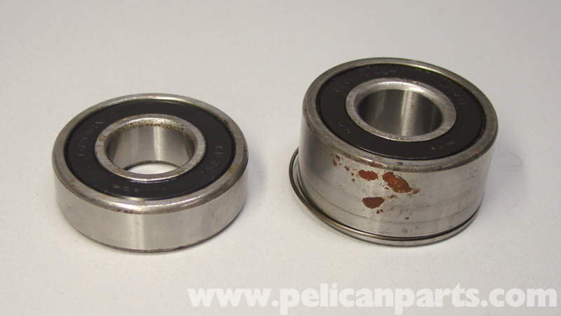

tonycarreon 09-11-2013 08:49 AM
Originally Posted by haz (Post 362595)
Could you explain how I can see? Are there two sets of rows for the balls?
the dual-row bearing is (by necessity) thicker and the cover is not as deep.
in the pics below the single row is on the left, dual row is on the right
http://986forum.com/forums/uploads01...1378914435.jpg
http://986forum.com/forums/uploads01...1378914447.jpg
