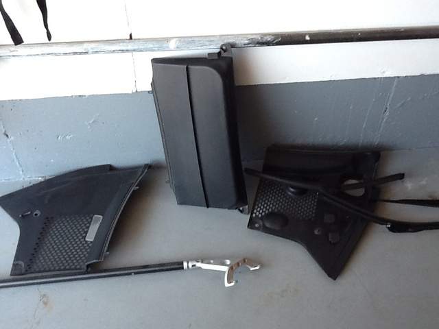

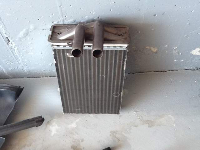

Update
Just a few pics from last weekend. I checked the "flap" to see if the foam is still there (it was). Not so difficult of a job.
As mentioned earlier, a quick recharge solved my issues, blows on low at 38!
'14 Boxster

I hope this will help as well........ Unbelievable amount of crud!
