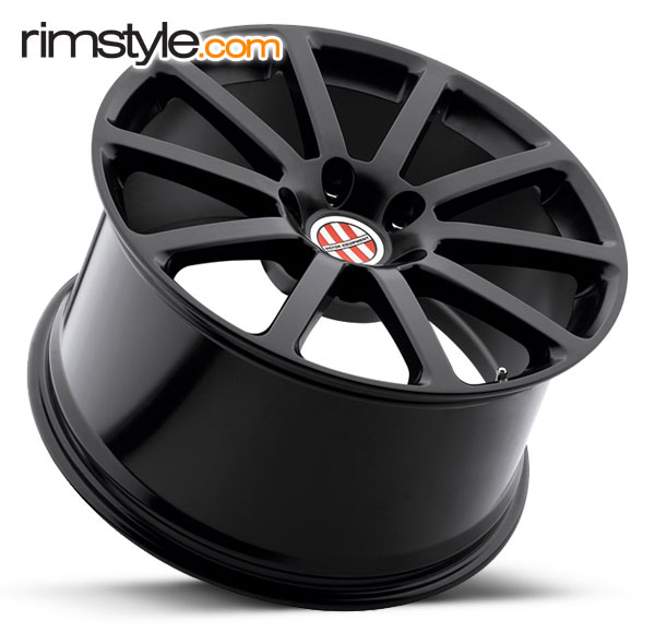

These are the tyre specs they suggest for the 19s Johnny..
19" Victor Equipment Zehn
Alloy Wheel & Tyre Package
This Package Includes:
2x 19" Victor Equipment Zehn Alloy Wheels
(Wheel Specifications: 19 x 8.0" 5x130 ET45 FRONT)
(Wheel Specifications: 19 x 9.5" 5x130 ET49 REAR)
2x 235/35R19 Falken FK453 Tyres
(Tyre Specifications: 235/35R19 91Y XL FRONT)
2x 265/30R19 Falken FK453 Tyres
(Tyre Specifications: 265/30R19 93Y XL REAR)
Would prefer 35 profile i think on the rears......

I wouldn't change the aspect ratio on the rears - stick with 30's . However, I would recommend going with 275's instead of 265's . IMO it strikes a better balance with 235's up front.

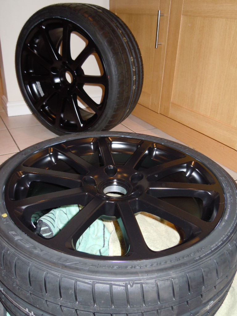

Well two of the wheels have turned up today..so have given them a coat of Rimwax before i fit them on...Look good...although i am suprised or not? they are made in China !
The other two are on their way and should be here tomorrow. Gonna hunt down some black Porsche wheel caps now instead of painting mine up..
