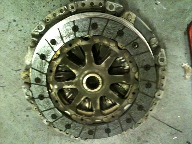

finally got my car in to my local indy mechanic for inspection, as i was getting some clutch chatter and slip. he reported back that it needs a new clutch kit, flywheel, and im going to do LN ims upgrade while its apart my factory bearing is leaking at the seal, the quote is for 3700 parts and labor. is this online with what you guys paid when you went through this common procedure? the mechanic is going to send some photos of all the old parts ill post when i get them he said 2 of the fingers on the pressure plate were cracked and the throw out bearing was pretty bad..

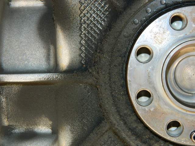

here are some photos of the disaster sandwiched between my transmission and engine-so glad i took it in today. that ims leak doesnt look too good. 2002 S with 88,000 miles- original clutch-he said rms had been updated previously and is not leaking-he also brought to my attention the 2 fingers in the 3 oclock position on my pressure plate were cracked

Right in the ballpark. I'd say that clutch chatter saved your motor. Your IMS was at stage 4 failure.

Wow... no RMS leak.

Should I replace that RMS anyway? It's apart and the seal is cheap enough

Looks like it was already updated.
Not only that you, also have the updated case bolts.
With that said, they are already there, and the part is cheap. Replace it.

i can also tell you have the updated RMS (that's why its not leaking Jager ) since the old one has circled imprints on it, and installed almost flush with the case.
the new RMS has rectangular imprints and seats 3mm inside the case (13mm from the tip of the crank)
