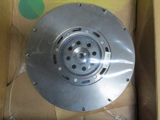

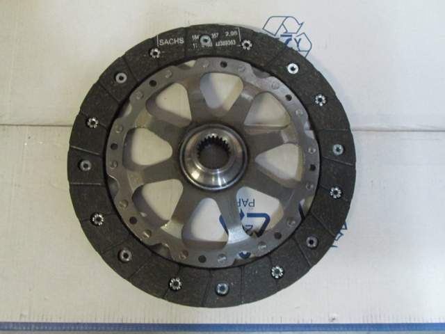

img]http://986forum.com/forums/uploads01/image1358905732.jpg[/img
shiny new parts

nice.
i always like to see new parts
you gonna love your car even more with the new clutch on.
i almost made a hole in the floor, when i pressed the clutch pedal for the first time.

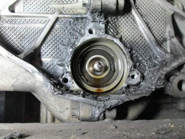

Originally Posted by oc-boxster View Post
Thanks guys! Feeling good about the decision I made not to wait any longer for some reason I was thinking my ims would be fine, I thought wrong-way wrong!
Do let us know the condition of the old bearing. I see that the IMS cover is leaking, as much as others suggest that it's a definite IMS failure, the only thing that's definite from your photos is IMS cover failure...keep us posted!

My mechanic just sent me these photos-without speaking to him I'm assuming the first two are of the original bearing and the third is of the new one installed.

Well, the bearing looks intact.
Once you have it in your hand, you will be able to check for play.

Got my car and old parts back. I can't even describe the difference it's like a brand new car to me-I haven't broken the old bearing open but there is a lot of play in the center shaft and it sounds like a bag of marbles if I shake it
