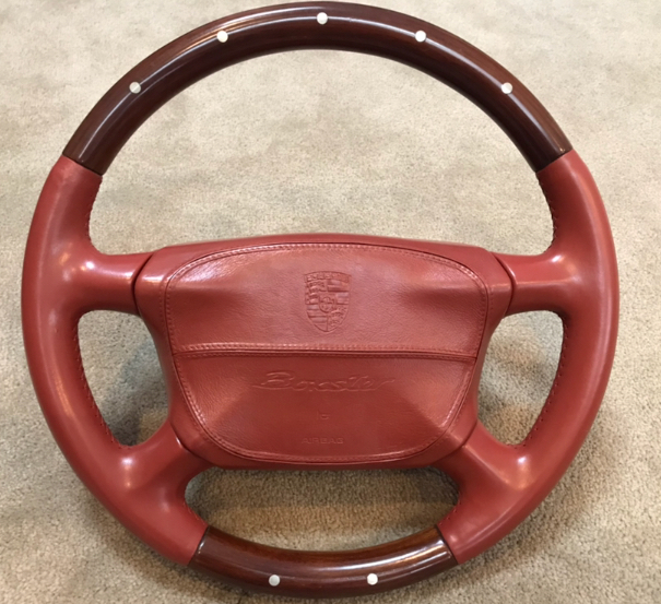

Boxstard 11-18-2018 05:46 PM
Refinished leather on my XNE steering wheel, using Leather Magic kit.
Attachment 21749
Leather around 10 o’clock got worn down and became rough and sticky especially under high humidity... so applied flexible artificial leather patch to fill a small hole and beef up thinned area before coloring. Hope it lasts another 20 years!
