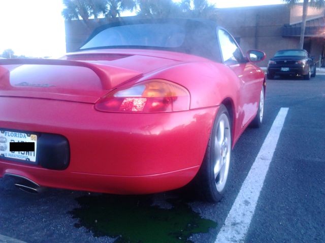

Waterpump replaced, now overheating issues
Just replaced my waterpump. $1025.00. Now my coolant drains, and the temp guage is flashing, than steady red light, as the temp guage reads at high temperatures. I returned it back at the shop today. I cannot wait for this estimate or diagnosis. I am hoping it was the pump of course... "Porsche..There is no substitute!"
The picture was taken when the waterpump failed.....

probably wasn't flushed / bled correctly. air pocket in the system can cause overheating.
flashing light = "low coolant"
steady light = "overheating"

I think tonyc nailed it, plus it sounds like your shop didn't complete testing on your car before taking your money.

There is a very specific process for bleeding the air out of the cooling system after draining the coolant. After I replaced my water pump, the coolant level went down ¾ gallon during the first time I drove it with the bleeder valve open. If your shop hasn't done this, then they didn't do it correctly unless they used a vacuum filler system.
