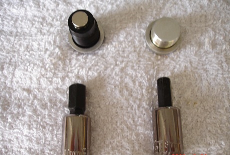

LN Engineering recommends no longer than 5k miles, as the oil starts to breakdown at that point. Also, their magnetic drain plug is well worth the investment; not only attracts metal particles, but is much more robust so you can't strip it upon removal (you must have over-tightened it).
Yep, it takes a bigger tool to remove the LNE plug. Here is a photo with the LNE plug next to the stock plug:
