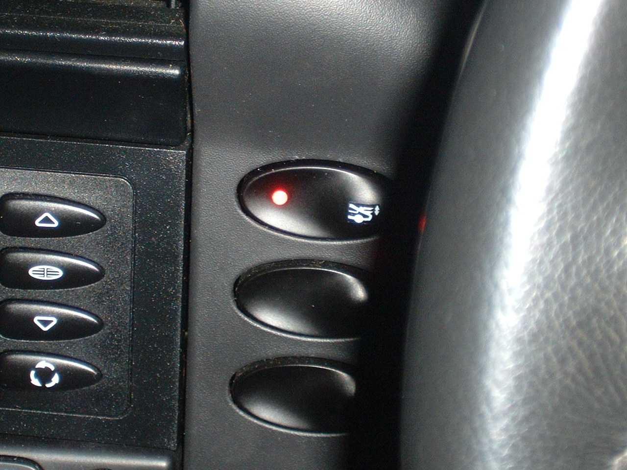

I have a dash board switch that lets me know when it's going up flashing Red LED at 75 MPH (in my Boxster) solid Red LED
when up, and it will only come down (flashing Red LED) when doing 50 MPH, unless I press my other retracting button at 60 MPH
Name:  spoiler warning light 002.jpg
although I think the spoiler on the Boxster is fantastic looking bit of kit , it does get a bit embarrassing if after you have put
your foot down to say join a motorway from a slip road and the spoiler comes up, you then slow down to 60MPH and your
spoiler is still stuck up in the "go faster mode" until your speed comes down to 50MPH when it will retract automatically,
you get what we call over here in the UK "Boy racers" seeing this (Spoiler up) as an invitation to a race against them in their
Vauxhall corsa's, so that is why I've put this button in to retract it at 60 MPH one touch manually works a treat.

I know that's the correct up & down speeds but is that switch oem option?

Posts: 139
The one with the picture of a spoiler on it I got off eBay, the other one I mad up myself.
How did you wire this up? Just guessing you extended the wires from footwell?

Posts: 139
The top one is wired up behind the dashboard to the red spoiler warning light block connector, all the instructions came with the switch, the other one is as you say a direct wire from the foot-well switch, but only on the down motion of the switch.

Posts: 8
There is also a version of that top indicator which is also a control switch. Costs a bit more, odf course. Same seller on eBay sells both versions.

Where do I go to find out how to get the aforementioned button?
Try here. There are several versions, some just indicate, others also activate.
