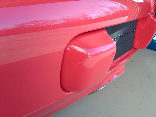

Posts: 4,810
Originally Posted by ddb
I think they look a lot better painted, especially on lighter colored cars. What color is yours?

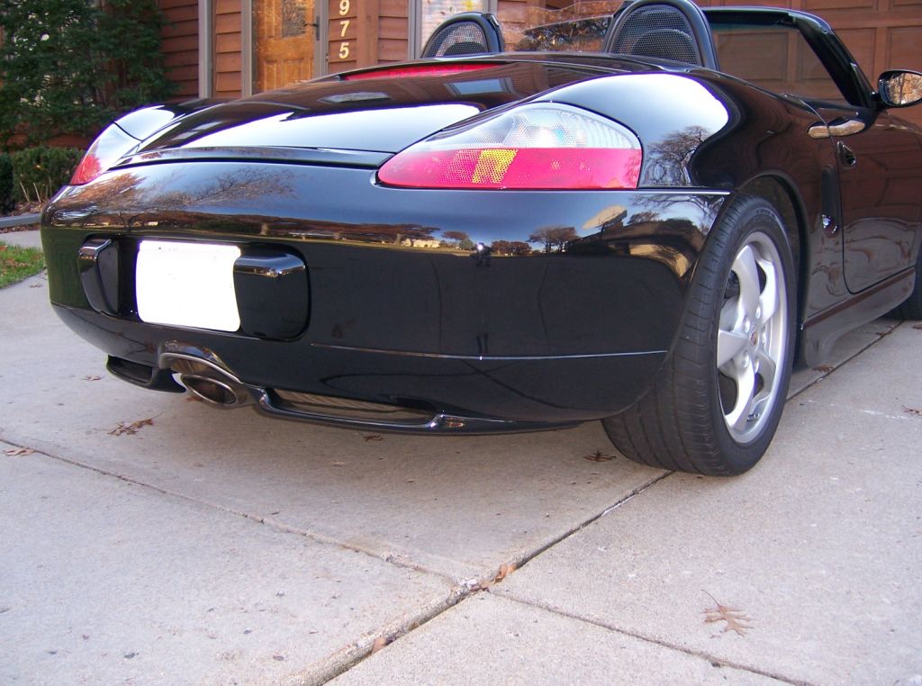

Location: MN
Posts: 327
Dark colors look great painted, too! Mine were already black, but smooth and shiny black looks way better. I'd always vote for painting them. I had bumperplugs do mine and they did a great job.

Location: Charlotte, NC
Posts: 926
I agree with you, MN 986. Your car looks fantastic. The bumperettes look better painted on all colors IMO. They just stand out more unpainted on the lighter colors. I would also rather wax them versus trying to avoid getting wax on them.
BumperPlugs did mine too, a little more than six years ago, and they still look great.

Posts: 236
BTW, I have a set of bumperettes for sale. PM me if interested.
ddb
Sorry to hi jack the original thread, but ddb, your car is AMAZING!!!
